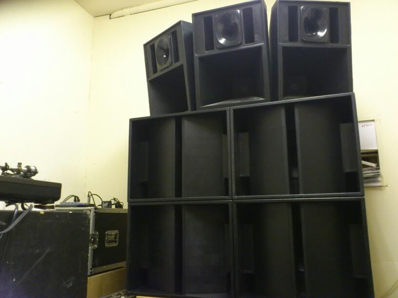

12" 6th BP Sub. PD12SB30 Loaded. Perfectly described in the name!!

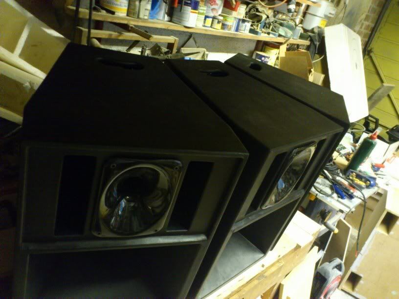

Tops. 8" Neo Beyma Ported horn, 1" BMS comp on eighteen sound horn. Sims say down to 100Hz but thts still to confirm

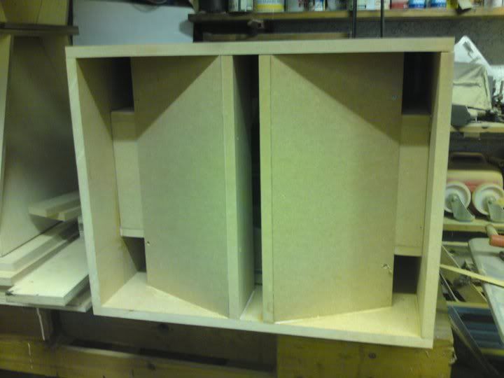

Kicks. 12" BPH. again PD loaded, smooth folded horn with no nasty sharp turns, prototype played well above 200hz with little honking
Missing kicks. Couldnt resist putting it together, just imagine the above pic inbetween the tops and subs
Amp rack. And powering it all, a nice void rack

nice to see some one using mdf, no doubt some "pro" will jump on here tellin you that you should be using 13lam birch ply LOL
looking good tho

good effort, loving the look and splay of your tops.
Did you design the 12" kicks completely from scratch?
I need to build some kicks but i could do with them being smaller than 15" purely to save weight and money.

All the mdf is treated b4 painting to toughen it up, something all the pro's should know.
Yes everything is designed from scratch, possibly stole some concepts but has been changed enough

any chance of seeing dimensions/plans for the kicks? Looking sick man ;)

You wouldn't want to share those 12" kick plans would you? I understand if your not cool with it.
Ive been looking for kick bins for a while now and i have found a good 15" turbosound design, but i would prefer the cabs to be smaller and lighter but on the same concept....like yours Embarrassed

Kicks are 600x600x480mm. Subs are 60mm deeper. Not sure wat im doin with plans, gona wait till ive done some proper testing and got some nice graphs to go with.

Is that just one kick box??

Post Options Post Options   Thanks (0) Thanks(0)   Quote TheAmazingGanjaMan Quote  Post ReplyReply Direct Link To This Post Posted: 14 February 2012 at 3:55pm
lol no its 4, pic was taken half way through build, u can see where the doors stick over the end of the box aswell.
