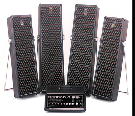

Nothing new under the sun - just a scaled-down version of these:
Early line-array!!  Smile

Absolutely, line array, collumn speaker all just names really.
HK claim wide coverage as the advantage of the column then quote 70deg horizontal. I wouldnt call that wide. They then show an optimum system with two subs stacked side by side with a collumn on each. So, collumns of three inch drivers about 18 inches apart playing mid/high freqs. Sounds like lots of lobing /combing possibilities there!
