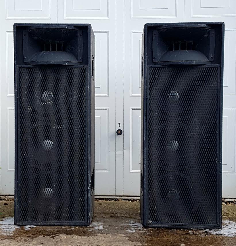

Thought it would be easier to start a new post around the Martin Audio H350s that Ive recently purchased.
Have given these a quick wash and had a little peak inside Im intending the strip the woodwork back, then Tuff Cab, but need to finish my Cubos im building first before playing with these

They look in good condition good luck on the refurb.... also have a look at Warnex, much nicer paint.

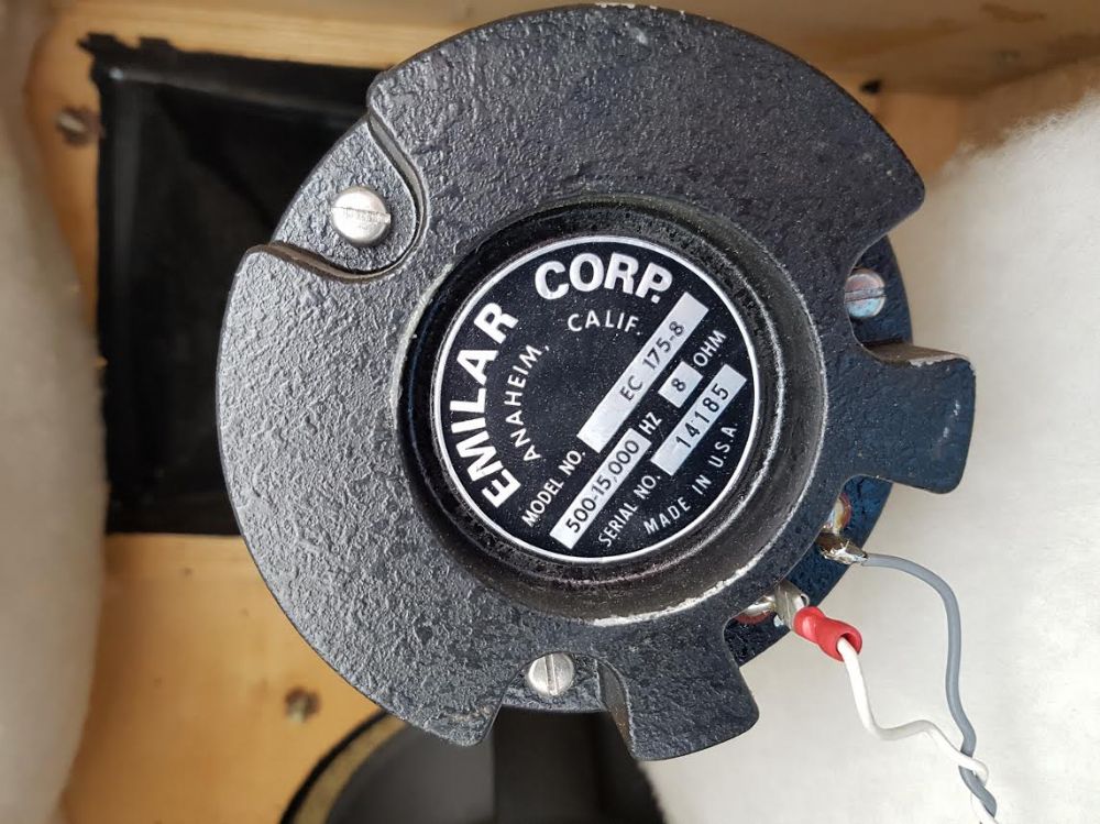

You have been very lucky there as they seem to be fitted with the original RCF L12P-24 12" drivers which are absolutely superb but The Emilars are a bit naff really as they are quite a dull 1" driver with a low ultra HF response--If you are not bothered about keeping them all original then bolt a pair of B+C DE250 HF drivers into them to give you a brilliant sparkling top end and also will sound so much sweeter.
These look like a different pair of cabinets to the ones on Ebay as the pics on Ebay do not show any chrome dustcaps on the six 12" drivers hence me thinking that they were probably loaded with ATCs. |

I have some emilar "bowtie" horns that use those compression drivers which I don't have.
