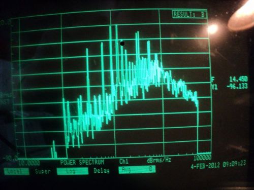

First set of results for the Mixer/Amplifier combination showing a 'normal' input level and an overloaded input:
Firstly a two tone signal applied to the Mixer Input at a level so as not to overload the Input and monitored at the Amplifier output:
A spectrum analysis of this signal below:
Now with the input gain of the Cloud increased to maximum so as to overload the input stage; the Output waveform of the Amplifier is:
and the Spectrum of this composite 2 tone signal generates this:
It can be seen that there are a substantial number of artifacts compared with the non-overloaded input signal both as a result of the clipping and intermodulation products.
The test frequencies used are 960 and 1120Hz and the measured Amplifier output was of the order of 5V rms.
As to how much additional energy is passed to a 'speaker by the 'overload signal' compared with the base-line one, the Spectrum Analyser results show a substantial difference.

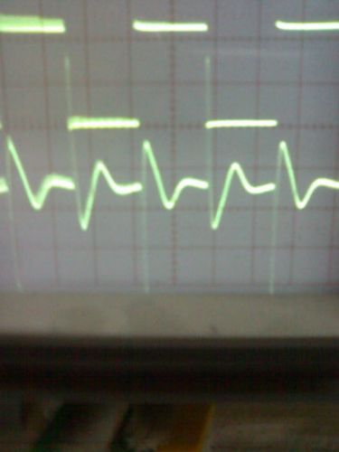

Ok, had another look today - both the DCX and a BSS 360. The other day I didn´t run the square wave into the DCX, just checked on it´s response to overloading, ie how well it´s limiters worked and they did ok. Today I did the square wave tests and there wasn´t much difference between the o/p of the BSS and the DCX.
60Hz, 2,5V square:
BSS, Low Out:
Mid Out:
Top Out:
Sorry about the bad pic, but we see that there´s still harmonics getting through from a 60Hz, square!
Now 600Hz:
BSS Mid Out:
Top Out:
Now the DCX:
60Hz, Low Out:
Mid Out:
600Hz, Mid Out:
Top Out:
I haven´t checked on how the DCX actually works, but if it is FIR.... Confused

Post Options Post Options   Thanks (0) Thanks(0)   Quote audiomik Quote  Post ReplyReply Direct Link To This Post Posted: 05 February 2012 at 4:26pm
OK, initial tests using same setup as before with a 1kHz HP LR Filter setting for the LEM:
Squarewave at 1kHz input with the Amplifier output in the centre of the screen:
And the output spectrum of the filter:
Measurement Error: Next an expanded timebase of 0.1mS/div to look closely at the time difference of the zero crossing point of the output compared with the input signal to assess latency.
OK, - a fundamental error in measuring the Latency by using the 1kHz square wave input which obscured a 1mS difference from the real value of this timing difference as it appeared on the next cycle of the waveform.
Corrected in the 'scope image below, using a 100Hz square wave and 1mS/div timebase, which shows a more realistic figure of 1.2mS for the delay between input and Hi-Pass output of the test setup:
