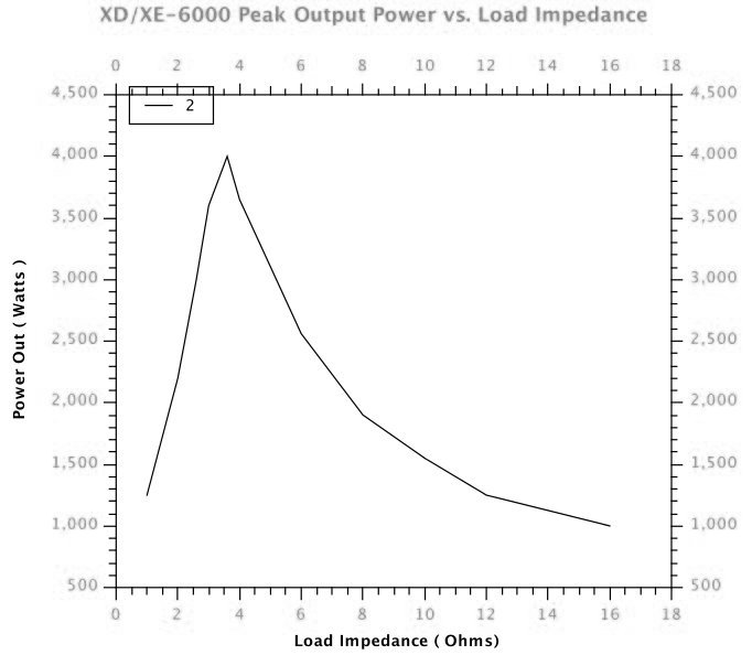

Originally posted by Nitz V1505 Nitz V1505 wrote:
Sorry for the double post. Dumb smart phone posting before I had finished!!!! Peter can the 6000 go lower than 2.66ohms?
Thanks for the info CSG. Im just after a monster amp that can power 4 G subs or 8 scoops which sound as good as my heavies without breaking the bank.
Here the optimal loading range of XE/XD6000 are clearly visible:
