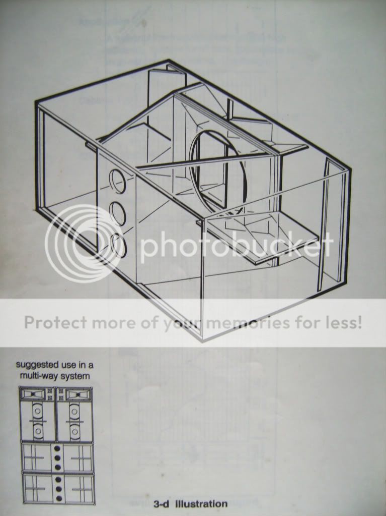

building a new system @ moment, i need of plans for 18" & 15" ported w-bins simular to the jbl style dont want double as they r far 2 hefty 2 get up stairs n so on, if any 1 could help would b most appriciated cheers

18"

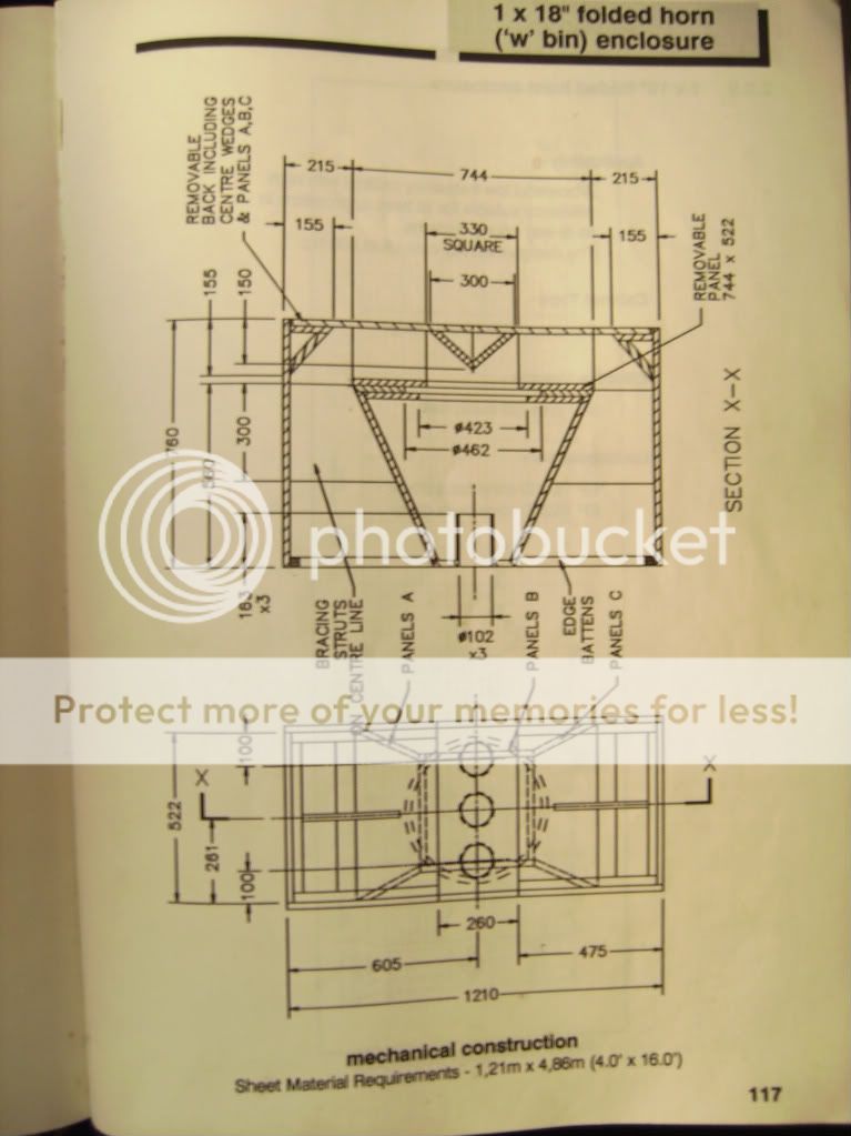

here you go this is an eminence design.
quite a nice looking design i think. Smile

http://forums.klipsch.com/forums/storage/6/775818/Keele_W_BoxPlansPDF.pdf
These are the single 18 plans for the JBL. Other possible speakers have been discussed before, but I can't find the link now.

The Keele plan is better because of how the driver loads.
