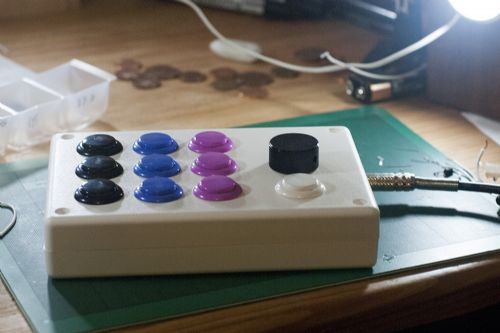

Alright, here's what I've come up with Cool
120 X 170mm box with 10 arcade buttons  and one potentiometer, inspiration from the Midi Fighter controller from DJtechtools.com. Powered by batteries for now, but easy enough to add a wired connection if I fancied it. I already have some of the parts for an A stable vibrator and I managed to get one to sim quite nicely so I'm going with that.
There are 3 channels with 3 buttons each, the buttons are either 1/2/4 flashes per beat, and each channel is tuned to one of my most commonly used BPMs.
The potentiometer and extra button are  there to allow anything from 0.5-18Hz.
should get it built this week and give it a test on friday Smile
Any thoughts? extra little features I could chuck in whilst I'm at it?

I think this is the first time I've used simulations and calculations to build a circuit.
I was warned about tolerances, but I was still shocked by the difference between simulated behaviour and real life behaviour.
The rates were so drastically different with the calculated resistances I couldn't actually use the resistors I had bought. note to self, simulation isn't so theory isn't so reliable.
What I ended up doing was redesigning a few things and using a potentiometer to find the right frequency and measure the pots resistance once I had got a good sync.
