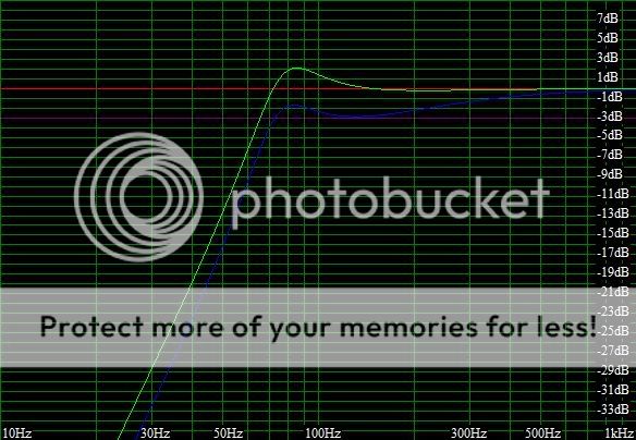

Blue is the B&C 12ndl76 and green is the BMS 12n620
Ive tryed the plot the with BMS 12n610
It looks better to me, I think changing the tuning frequency to about 65Hz will tame the low end peak.
what do people think?

diyxover: Its because the b&c has more spl in mids.look at the real spl plot at 1watt or max spl plot, then you ll see its almost the same spl in bass.
bms seems better above 1,2khz because of less mH...
