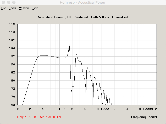

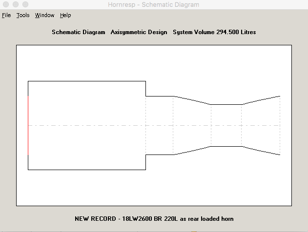

Thanks Toasty and Levyte. This Keele paper was quite interestind read. https://www.xlrtechs.com/dbkeele.com/PDF/Keele%20(2003-10%20AES%20Preprint)%20-%20Nom%20vs%20True%20Eff%20High%20BL.pdf The flared port part is another matter, but with such large air quantities moved, which is possible by modern high xmax drivers, a neccessity to keep the box tuning stabile, and box efficiency on the high side at high SPL. Was it some JBL white paper about this? This all is what this forum should be all about, dispersing knoledge. ![]() Last night I sketched a 215Lnet BR cab with venturi port with start and end area of 1200cm2 and the middle constricted section of 600cm2, with paper and pencil of course. Ended up quite big box for single 18" There was next problem, how to model the thing? After all I modeled it in hornresponse as backloaded horn with 215L throat chamber and converging-straight-diverging horn section as reflex tube. Maybe Akabak is next in line. The Keele paper gave answer to my wonderings about lowish and bumpy low end sensitivity. Probably I sholdn't be afraid to eq the hell out of it. ![]() ![]() ![]() There may be need to add a resonator to the reflex tube to kill the 176Hz peak.....and the straight section after the rear volume is in fact a 90degree turn inside the cabinet.... Seems to be sawdust time after my vacation is over. Sadly one cab eats more than two sheets of 4'by8' 18mm ply. -Andy

Got some suitable empty cabinets (ex jbl 2245) to try my 18LW2600's, instead of building them with insane ply prices. Vb 420L for two, tuned to 31Hz, tubes 4x 160mm. Quick 'n dirty processing needed +4dB shelf from 43Hz downwards and one notch at 140Hz, 24dB HP 24Hz & LP 110Hz Got them to first gig also, unfortunately at civilized volume corporate rock 'n roll event.... I'm very pleased with the results. I can only imagine 'em at war volume in apropriate venturi port cabinet, bangin proper techno and ambient Cheers, Andy
