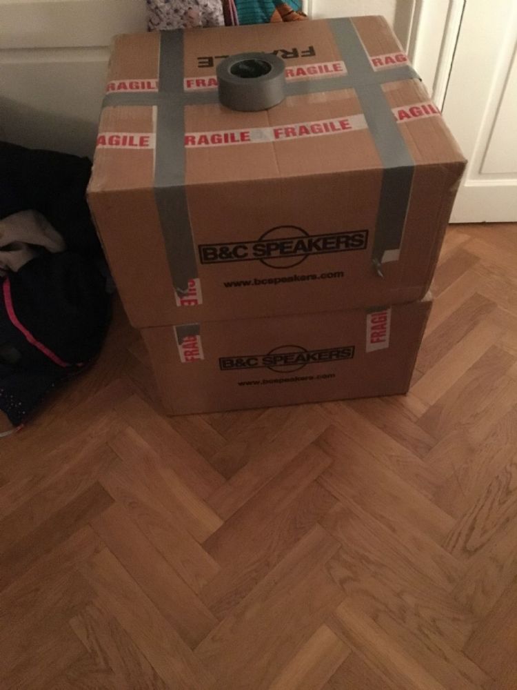

so I want to play around with them abit see if I can get one that will fit under my 215martins  , is there anyone apart from Toasty using tapped horns here ? Santa passed by me over Christmas and left these under the tree

Lucky you...I want your SantaWink
