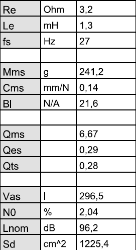

I have sourced all drivers for my rig. Mid-top and kick are all very good drivers, however, I have bought cheaper drivers to begin with for the scoop section. These are 4 ohm Lavoce SAF184.3 drivers. The 8ohm drivers look good on paper for their price. but now I asked more info about the 4ohm version and received these parameters:
Does anybody have any experience on using 4ohm drivers in scoops?
Cheers!

What design are your Scoops ?
Either way, that BL=21.6, tells you, this driver will not last very long, when Driver is pushed, or Sub boost applied.
Dependng on Scoop design, see paramters for Void V18-1000, B&C 18TBX100, B&C 18DS100,  PD 1852, 18sound 18NLW9601, for examples of drivers, very suited to Scoops.

Only BL won't tell you the whole story. To get correct motorstrength using something like BL^2/Re will give you a better approximation.
While the SAF184.03 still is not very high it surpasses the 18TBX100-8 at 145,8 vs 127,5.
So the 184.03 4 Ohm has a stronger motor than the 18TBX100-8.

that statement is overgeneralization. It only takes BL as the sole parameter to determine the strength of a speakers motor. Eventhough, BL is lower due to a shorter voice coil wire (thicker wire gives lower impedance). Because that same impedance is lower, it will result in a higher current for the same amount of power.  As current increases, magnetic forces will increase. In the end both Re and BL are intertwined and both can't describe the motor strength of a speaker alone.
Therefore, you are not gonna tell me that Ipal drivers are weak just because they have a low BL.

If you look at the specs on 4ohm vs 8ohm drivers the BL is always lower on the 4ohm version yet performance is very close between the 2 different impedances when driven to the same SPL.
For example the B&C 18TBX100, a perfectly usable driver, 8ohm version has a BL of 25.5 but the 4ohm version has a BL of 22.0.
