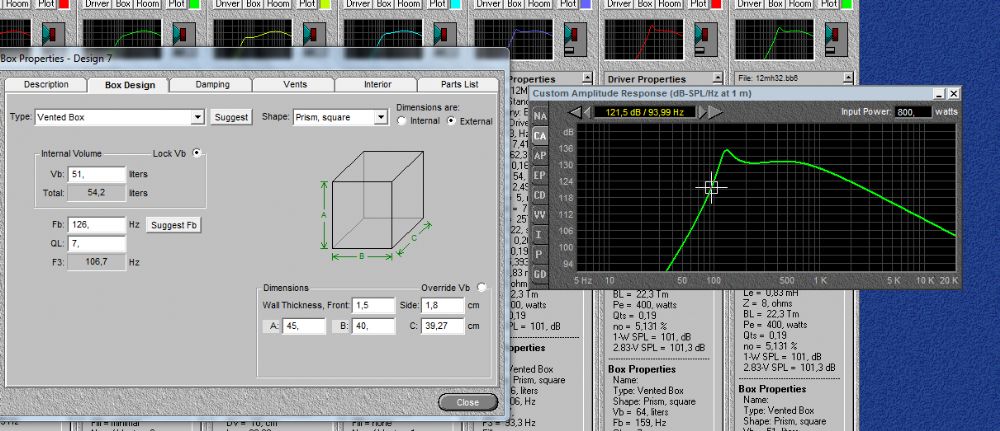

all suggested design by bb6 are around 15/20l that give me a very tiny box where almost fit the speaker that is 13,3cm deep with good f3 and fb but ports far to be possible... even if split ports in 2 or 4 reducing port size...allwayse too long
next step is sims it in very large box up to 51L and now things works but im afraid about box size.
what do you suggest me?
one typical example small box:
vents impossible to fit in.
secon option midvolume:
  No. of Vents = 2
    Vent shape = round
    Vent ends = one flush
    Dv =  152, mm
    Lv =  110,8 mm
third option large volume:
-vents are 1 diameter 12,92cm but Dv to small! so i think this design not possible
For all these sims no probs in phase or cone desplacement!

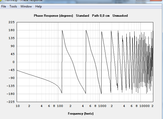

tonite i sims a very small horn (35cm) with a reflex... and looks good to me, until i move to phase window, that show me a very big mess. path are equal to 0. I was thinking to put it on the back side of the speaker chamber. is it possible? how can we deal with the messy phase?

Your phase graph looks pretty normal to me, the straight lines are 2Pi phase shifts and the graph wrapping around.
