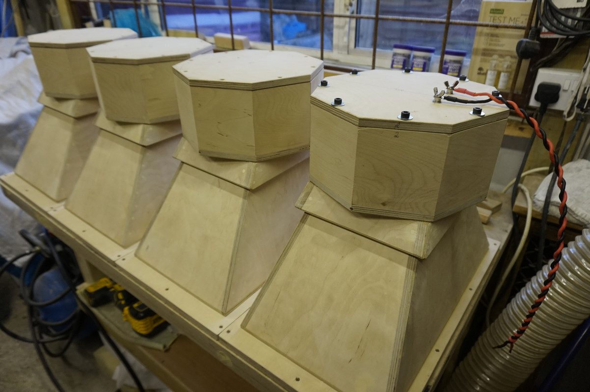

I agree totally with all of the compliments above as it does seem ages since we had an epic build on here---But(theres always a but) I just had a thought that it may have been easier to make a jig and make them out of fibreglass, especially if more are going to be required in the future.

Quality work there!

Maybe fibre glass would of made sense, but let’s face it if you can produce wood work at this standard its an art form. I’d love to hear them!

Top skills, love a biscuit or two!

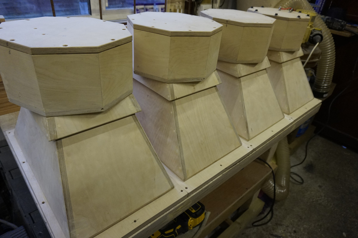

When I made horns like this years ago, I had a lot of trouble with the calculations for the compound mitre angles on the flare pieces. I didn't get it quite right and ended up with small gaps. Could you possibly explain how you worked them out?

Well,yes ,it is tricky,it was more like test and try
I had to sacrifice few bits of ply ,till i get it right

One possibility is to cut slightly oversize and do the final trimming with a well tuned hand plane. You would be amazed at the amount of accuracy you get with a little bit of practice!

I often cut compound mitres with my ts55 track saw, hand planes have their place, but they're not practical time wise if you're making multiples.

you can calculate them using trignometry and I have done so in the past. I can't quite explain it without drawing it all out though - it involves multiplying the angles by cos or sin of the flare angles. there's a calculator on this page under 'general compound angles 2'
edit:
for a square horn the bevel=45-(((invsin(cosAcosB))/2)
how you do it for a horn with more than four sides I can't quite get my head round

It's near impossible with a hand circular saw. They only bevel one way and it's always the wrong way. Cutting perfect matching panels near impossible. I am sure a few can do it.
The best way is to make an angled cut off jig for the table saw. You can get exactly matching panels. But yes it does always take a bit of trial and error.
