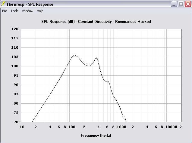

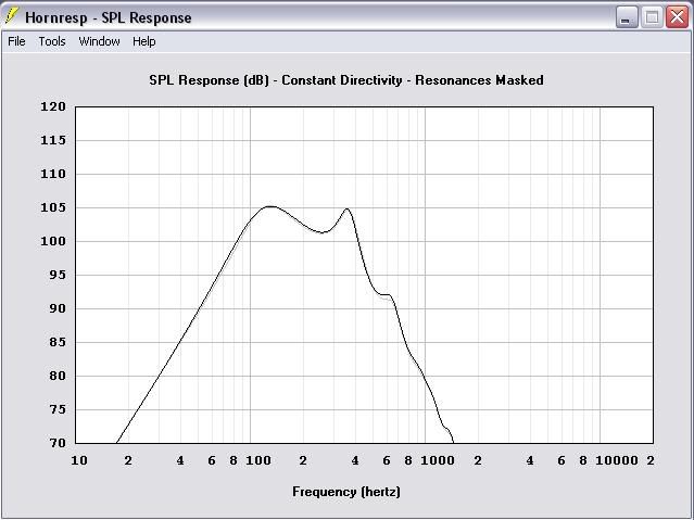

I've been looking into this lately cause I'm making the 15" section of the xtro seperately. I did get the ndl76 and tried it on my test cab that is similar to the xtro. I think that the NW76 that has a higher BL would be a better choice. Here's the hornresp plots if it's any help, for the original xtro cabinet for one 15".
nw76 =black nd930 = grey ![]() ndl76 = black nd930 = grey ![]() |

thanks a lot, this is what i want to hear

The 15NW76 will work fine in the Xtro, probably minimal difference between that and the 18Sound as the plots show. I use them in other cabs and they're great.
