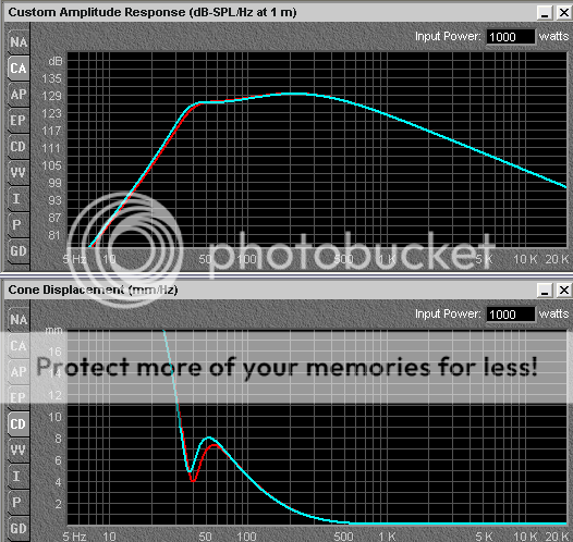

I maybe wrong but I'm pretty sure both chambers are tuned around 39 htz. The lower chamber is bigger but has a smaller port, also there is approx 4.5 Ltrs of wheel space to deduct!
so...including ports:
Vb top = approx 133
Vb Bottom = approx 170
I had already simmed the bottom part of this cab for a single cab project.
The plot for each chamber superimpose each other.
Regards...J

![]() Red top/Blue Bottom chamber. Ports calculated using cross sectional area and length. Combined sub & kick cab bi-amped, is an interesting idea!
I'm just looking at the the sub atm.
Regards...J |
