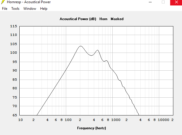

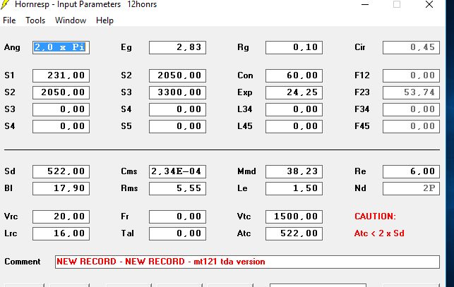

Originally posted by Bee Bee wrote:
MT121
s1=360.8
s2=872.2
con=25.3
s3=1944
con=21
vrc=17.6
lrc=14.8
fr=0
tal=0
atc=1108
vtc=615.75
MT121 TDA version
s1=360.8
s2=1944
con=47.8
vrc=17.6
lrc=14.8
fr=0
tal=0
atc=1108
vtc=615.75
The inputs are equals to mine! where im wrong?
masking the resonance?
did not add or subtract the speaker volume?
Originally posted by <span style=font-family: Arial, Helvetica, sans-serif; font-size: 15px; font-weight: bold;>mobiele eenheid </span> mobiele eenheid  wrote:
You should use directivity, that's easiest for TDA's version and sim in 4,0 pi as well.
Im a real newbie but here some plots:
without using directivity 4pxi sims of 121 tda version
121 tda varsion 4pxi in directivity equals to "0"
results are so far... i need to improve my knowledge over this sims prog!
Originally posted by <span style=font-family: Arial, Helvetica, sans-serif; font-size: 15px; font-weight: bold;>_djk_ </span> _djk_  wrote:
these sims is about 2x b&c 12pe32 loaded as? is loooking like a dreaming horn lol
but correct me if im wrong:
are u simulating without mask the resonance? is that the correct way?
cheers

Post Options Post Options   Thanks (0) Thanks(0)   Quote _djk_ Quote  Post ReplyReply Direct Link To This Post Posted: 19 November 2016 at 9:38pm
"are u simulating without mask the resonance? is that the correct way?"
Yes, if you want to see it with all the nasties that may pop up.
I generally check it both ways, and show the worst.
"these sims is about 2x b&c 12pe32 loaded as? is loooking like a dreaming horn lol"
It looks pretty good, that's why I posted it.
I have the drivers sitting here, but haven't started to cut the wood yet. I have several alternate designs (with two 12PE32) in use, so I am in no hurry.
djk

Post Options Post Options   Thanks (0) Thanks(0)   Quote _Natty_ Quote  Post ReplyReply Direct Link To This Post Posted: 21 November 2016 at 2:21pm
ive made some sims, both with mine 12hpl76
1 single speaker (is it the correct way to do it?)
another with 2 12hpl76.
correct if im wrong but the extension and the much more power comes from the double driver mor thant the project...others horn are about single driver so is more corretc to compare them as single speakers!
