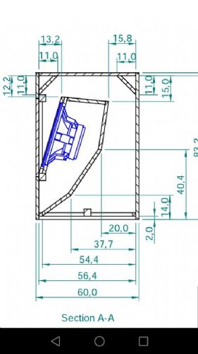

Yeah, itnis chocking... I will show you The design..
LeruSound
Registered User Joined: 27 August 2015 Status: Offline Points: 171 |
It is 574 mm Deep..

Old Croc Joined: 14 June 2011 Location: Middlesex Status: Offline Points: 4553 |
ok that's not a bph, that's a short front loaded horn, it wont go higher than 150hz, no amount of modding will get it higher. a BPH has 2 chambers front and back, look at the es18 bph design, down scale it to a 15" you wont be far off what you need.
U think so? So i will try to go down to 160 hz as i planned to do. Hope that with a good work of eq without go heavy on mt lowers could be The first step. What about The rest? I saw this cab got a resonance around 150 hz, wich driver should i choose? Higher BL enphasizes that resonance but give me better basses. Maybe i could stay where i am with Qts (0.31 0.33), try to rise The qms as possibile, stay with a medium BL that gives me enough strongness to drive that short horn ( 22 24). What about a good Vas for a 94 lt of this BpH? I think to stay stiffer (100 120) and fill The chamber with dacron, could it be a good move for what i'm looking for? Es18 is a kinda horn which i really like, but i would like to get more impact, i thought this hb15 could have been a in a good stance.
