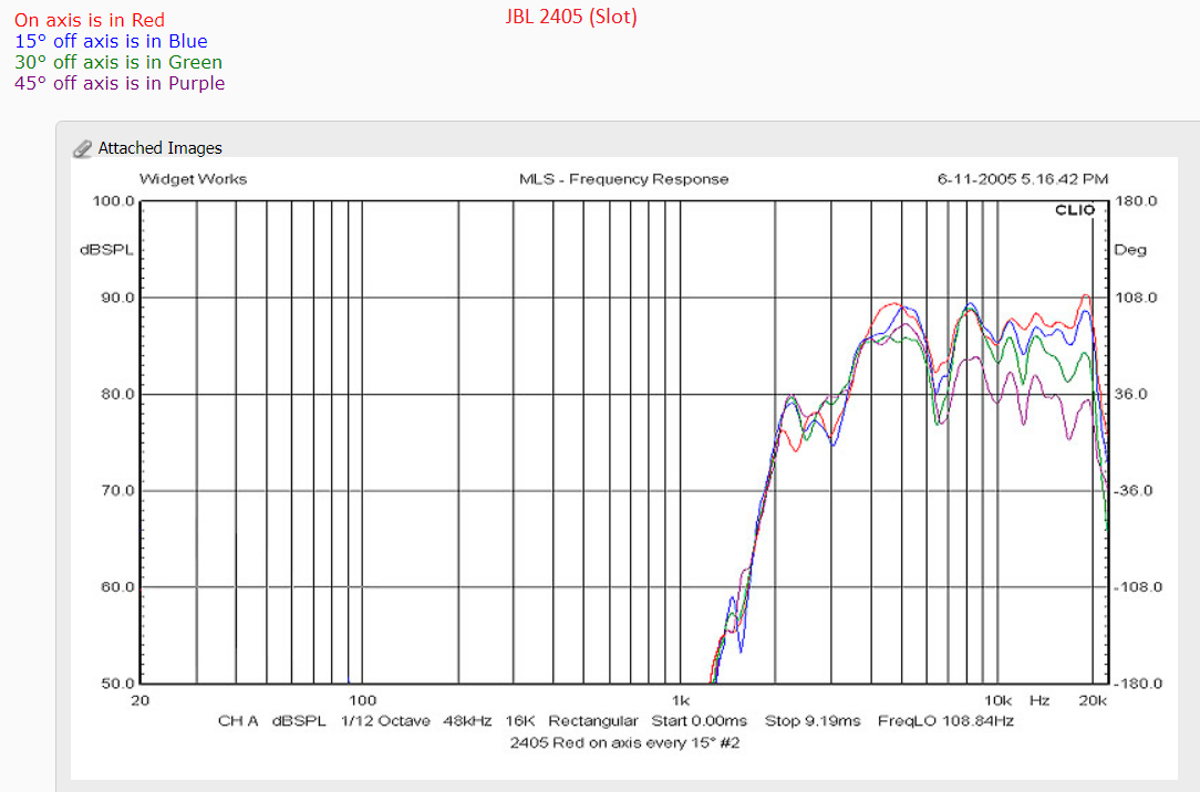

When you say slots do you mean something like beyma CP21/f Edited by Scruf01 - 22 November 2025 at 5:58pm |
Elliot Thompson
Joined: 02 April 2004 Location: United States Status: Offline Points: 5365 |
Posted: 23 November 2025 at 3:29am |
Yes. That is what is considered slots. JBL 2405 was the original and Beyma offered their version once JBL discontinued their version. Best Regards,

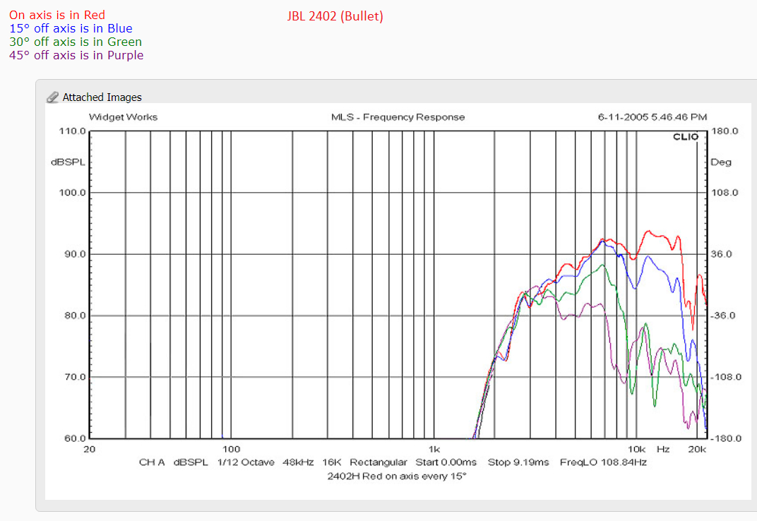

Posted: 23 November 2025 at 3:24pm |
Taken from Lansing Heritage
![]() ![]() Best Regards,
