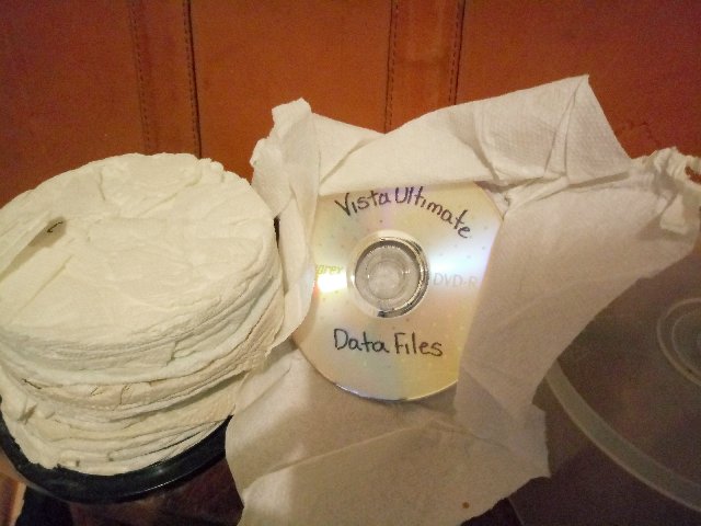

When I look at the ratio of which hard drives died and which ones survived during a 20-year-period it was always the drives that had to store thousands of miniscule .dll files. I do recall upon transferring the files from the old hard drive to the new hard drive, the time duration was longer transferring .dll files than .exe files despite the .dll files offered a smaller folder size than the .exe file folder. I would imagine quantity over file size is a heavier workload.
This is pretty much how I store my backup files that are on CDR/DVDR discs. The discolouration on the paper towel is due to it's age (13 years old).
