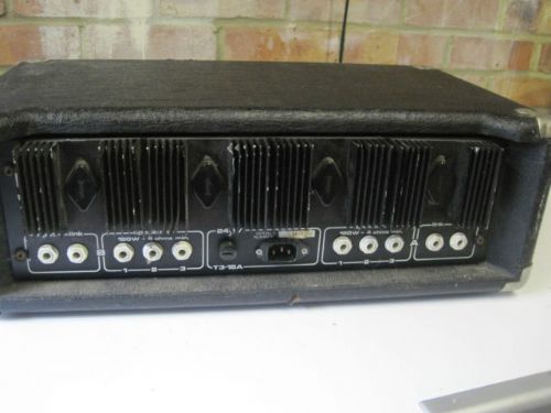

Hi just a quick question
where can i buy the covers for the rear amp for a cloud as pictured (not for this amp lol ) also the fuse holder its a T3 15A
many thanks dusty

I presume you mean covers for the output transistors
If so
http://www.ebay.co.uk/itm/5-X-TRANSISTOR-COVER-Part-M414-TO3-/271226778659?pt=UK_Computing_Other_Computing_Networking&hash=item3f26603423
As for the fuse it is a 3.15amp  slow blow type  most likely 20mm  any panel fuse holder could be used
http://www.ebay.co.uk/itm/PANEL-MOUNT-FUSE-HOLDER-FOR-5mm-x-20mm-FUSES-Pack-of-2-/300709626060?pt=UK_Sound_Vision_Other&hash=item4603b0c0cc
