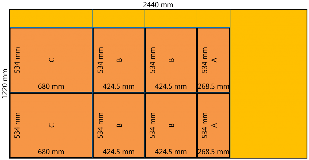

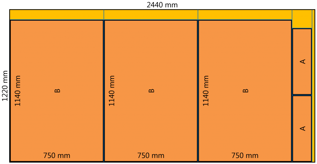

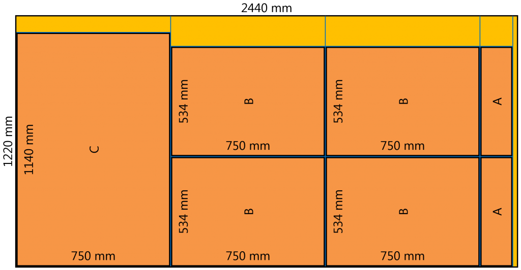

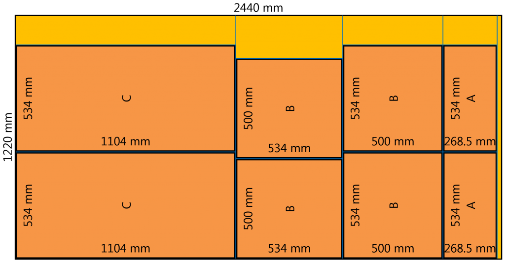

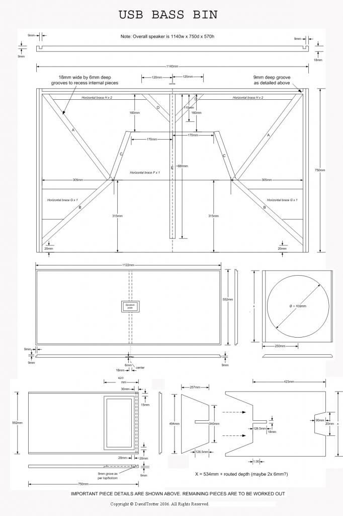

evening all! iv finally finished my new works shop and a pallet of birch just landed on my lap Wink first of all im gonna get building some USB's but iv searched high and low for plans and iv come up with f**k all so im going to do my own and put this plan to rest! This is for a pair of cabs so if you are only building one then just half it Smile This cut sheet is for a butt jointed build not rebated as on the plan.
4: top/bot - 1140 x 750
4: sides - 534 x 750
2: back - 1104 x 534
4: A - 500 x 534  35 and 7 degrees
4: B - 424 x 534  45 and 7 degrees
4: C - 268 x 534  15 and 38 degrees
4: D - 154 x 534  .45 degrees at both end
2: E - 680 x 534 work out angles from plan
2: F - 494 x 297 work out angles from plan
here are the screen shots from maxcut, as good as maxcut is there a few things id change on these.. this is for 2 cabs and it works out at just over 3 and a half sheets that leaves you enough for batons or a one piece for the access panel and also off cuts for the smaller braces in the chamber. ignore the letters on these sheets!! the above letters are for the actual usb plans above.
hope this helps Embarrassed
Adam
Edited by hmaudio - 04 March 2014 at 12:49am

why is the third sheet messed up?

a usb with bracing works out at 2.3 sheets per cab, based on 2 cabs.... using maxcut, for a fully rebated version rebate depth 5mm

all edited and iv added all the bracing and its well under 4 sheets Big smile
