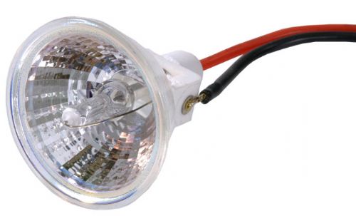

Post Options Post Options   Thanks (0) Thanks(0)   Quote kedwardsleisure Quote  Post ReplyReply Direct Link To This Post Posted: 27 September 2011 at 11:26pm
Those iRock scanners (Acme) take the notorious chinese Xenpow HID-150 mini discharge lamp with built in dichroic reflector. Expensive and short-lived. They often explode in a shower of glass shards.
Particularly being a plastic bodied thing, I'd be reluctant to recommend changing them to another lamp type. You'd have to remove the ignitor and ballast and fit a mains transformer as well.
Switch them on at the start of the night and only switch them off when you've finished and ready to go. You can black them out during the buffet. Every switch-on of the lamp knocks hours off its already short life.
