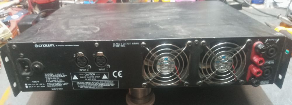

Hi. Someone has offered a couple of these to me:-- ![]() ![]() ![]() ![]() The asking price isn't too bad - but no model numbers! I presume XLS602. Can anyone confirm - and if they are worth bothering with -- or just doorstops... Cheers. |

I think that's a 402 rather than a 602, it's a c-audio GB402 in a different box.
Decent enough, british designed, mildly fiddly to service due to single board construction but they sold tons in the old and new form. Have a tendency to fill up with dust from my experience.

Weight it. Easy way to tell what model it is then.
XLS-202: 21.0 lbs. (9.5 kg). XLS-402: 25.3 lbs. (11.5 kg) XLS-602: 27.2 lbs. (12.3 kg)

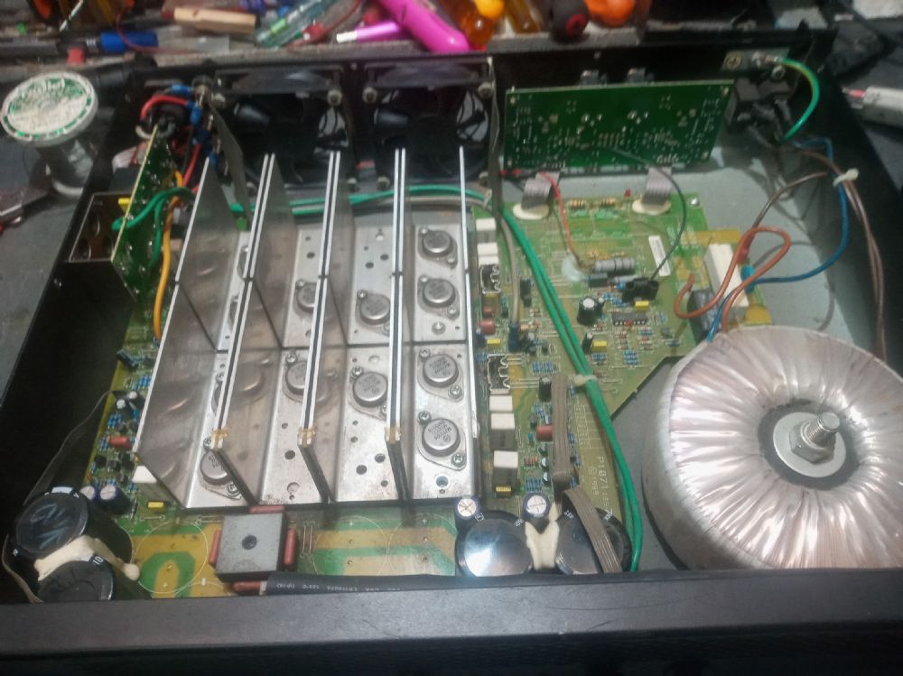

Aaah - ok, cheers. ![]() I do like the fact that there are "proper" TO3's in there, NOT Class D - and no SMPS. Always a good sign. ![]() The one I opened was a bit dusty, but not too bad. Under the main board was actually really clean. The dropper resistor for the fans was a bit brown, but that's normal. I was a bit curious about the lack of model number, though. I need to ask the owner what happened there. Chinese glue?? ![]() |

Ok, cheers. Or the number of o/p devices... ![]() |
