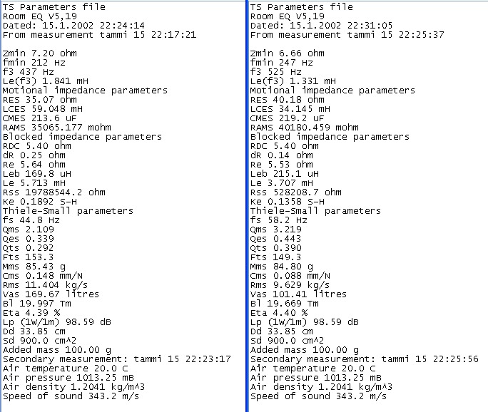

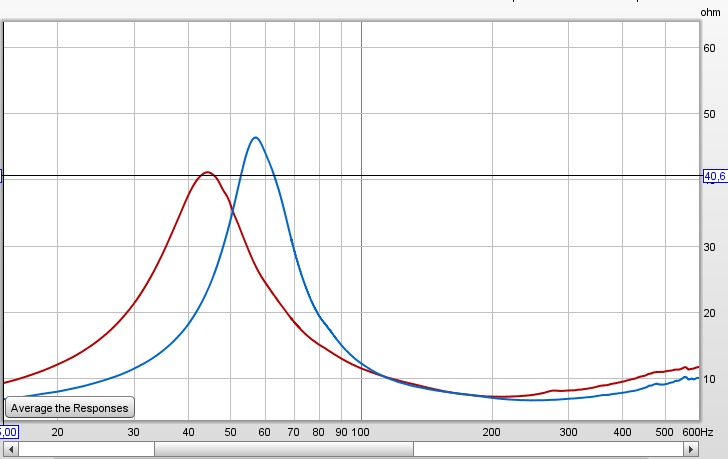

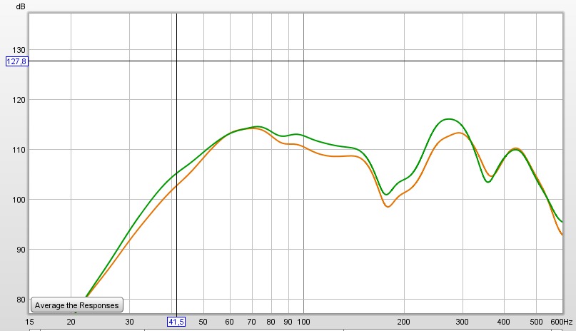

Further investigations.
I have two versions of L15P540, old and new (almost brand new actually). Old version has smaller vent hole and less ribbed cone (4 vs 5 ribs) but they work.
I measured thiele small parameters and frequency response in Tham 15, and there seems to be differences - actually quite a lot! Check this out.
Left: old used one, Right: new.  New one has good match with manufacrurer specs.
Impedance curvers, bare drivers, blue is new and red is old version):
Freq. Response (green new, orange old):
I'm not sure what's going on there, why old version has much lower Qts?  New version has anyway better performance in Tham as can be seen.

You are comparing an old driver versus a new driver. The older driver has been used more and broken in thus, the differential in the Qts & fs. Its like buying a brand new pair of shoes of the exact brand in addition to model number and wondering why the older shoes feel more comfortable.
Your limiting factor is not the speaker but, more so the enclosure. The loudspeaker cannot give you more for the cabinet does not meet the requirements needed for the loudspeaker to deliver an extended frequency response.
This is why TS Parameters of Loudspeakers are measured in Free Air as the loudspeaker is not restricted  by enclosure limitations. The vast majority build cabinets too small for the loudspeaker. This is why every large loudspeaker placed in a small enclosure requires a lot of equalisation and use a lot of excursion to deliver those lower notes at a significant sound pressure level.
