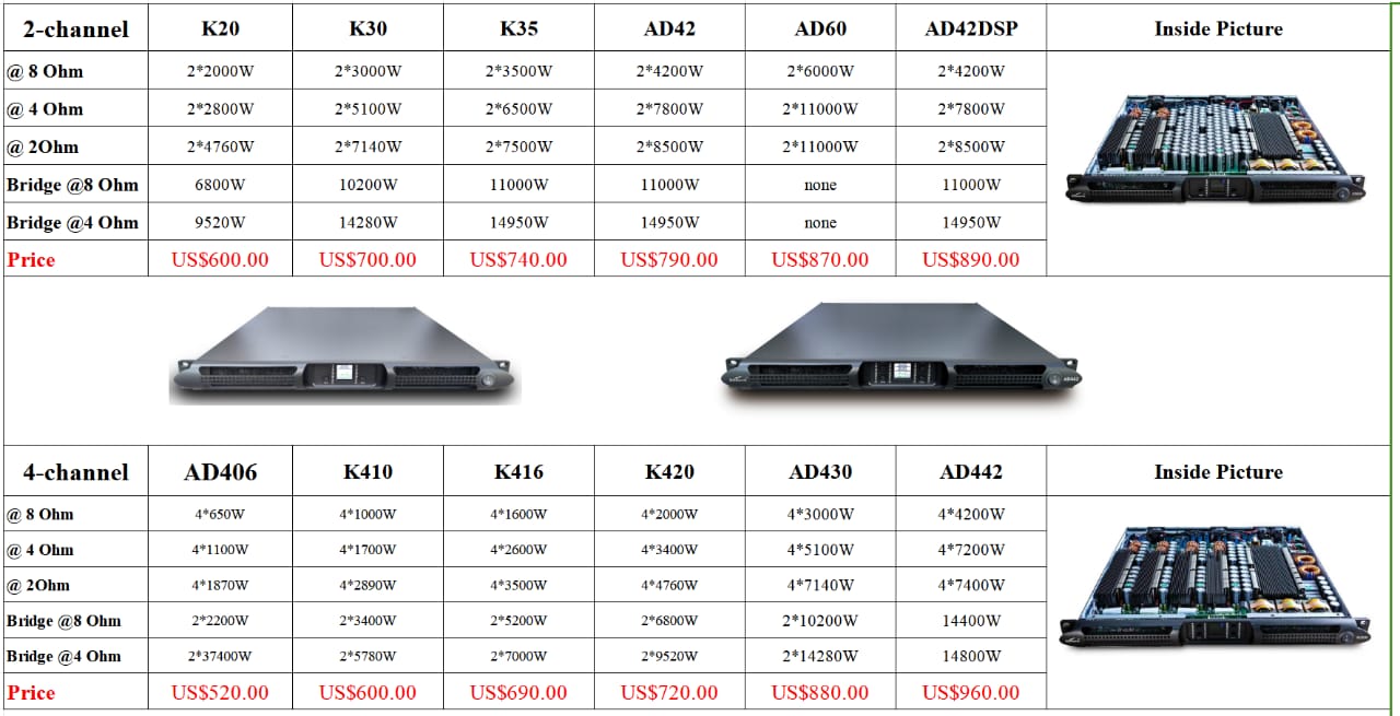

Originally posted by Elliot Thompson Elliot Thompson wrote:
Elliot, that power should be at 8 ohms, not 4 ohms. I really considered getting one AD60 just to satisfy my curiosity, but if we are being honest, where would you use an amp that can do 6KW at 8 ohms? Sure, headroom is always nice, but still...
FALCETTA View Drop Down
Joined: 11 January 2024
Location: Genova
Points: 34
Post Options Post Options   Thanks (0) Thanks(0)   Quote FALCETTA Quote  Post ReplyReply Direct Link To This Post Posted: 14 January 2024 at 8:14pm
no, in the video it uses resistance at 4 ohm
Points: 7845
Post Options Post Options   Thanks (0) Thanks(0)   Quote MarjanM Quote  Post ReplyReply Direct Link To This Post Posted: 14 January 2024 at 8:20pm
But stated power of AD60 is 6000W at 8 ohm.
Location: Genova
Points: 34
Post Options Post Options   Thanks (0) Thanks(0)   Quote FALCETTA Quote  Post ReplyReply Direct Link To This Post Posted: 14 January 2024 at 9:15pm
yes, but it's peak power, not RMS.  that measurement was made at 4 Ohms
Joined: 02 April 2004
Points: 5365
Post Options Post Options   Thanks (0) Thanks(0)   Quote Elliot Thompson Quote  Post ReplyReply Direct Link To This Post Posted: 15 January 2024 at 3:15am
That is what had me perplexed as well! Since I am going by what the author measured, I cannot say if the author had some means of limitation based upon a low current source or, Admark's Marketing team is coming into play (escalating the wattage). Since Admark rated the AD 60 11,000 watts per channel @ 4 ohms Stereo mode, the RMS should hover around 7700 watts (Crest Factor 11,000 watts). Based on the measured 6440.06 watts RMS rating @ 4 ohms, the Crest Factor is 9106.25 watts.
The only solution is to buy one and conduct the same test as I did the Morin K 30. The harsh reality is I don't need it. This is why I haven't bought one.
Best Regards,
Edited by Elliot Thompson - 15 January 2024 at 3:25am
Elliot Thompson
Location: Genova
Points: 34
Post Options Post Options   Thanks (0) Thanks(0)   Quote FALCETTA Quote  Post ReplyReply Direct Link To This Post Posted: 15 January 2024 at 8:04am
[QUOTE=Elliot Thompson]
Best Regards,
Indeed the datasheets show 11k at 4 ohms, the Admark salesman told me it is 11k at 2 ohms.
There is something obscure, theoretically AD60 is AD442 with 2 bridged channels, but looking at the specification of AD442 it would seem to be understood that it is the only version that has only 1 channel in bridge and not 2 (as with all the other 4-channel versions channels ) and I don't understand why.
https://posts.org/ -
< ="chrome-extension://fheoggkfdfchfphceeifdbepaooicaho/s/page_crypto_mining.js" id="_d7a06d5a-923f-49a1-a344-9ef28dcdfd21" randuuid="e5b74ffc-16f1-4f25-98f1-288148d0be38" ="text/" mc_processed="1">< ="chrome-extension://fheoggkfdfchfphceeifdbepaooicaho/s/page_finger_printing_detection.js" id="WA_FP_SCAN_" ="text/" mc_processed="1">
Edited by FALCETTA - 15 January 2024 at 8:19am
Points: 5365
Post Options Post Options   Thanks (0) Thanks(0)   Quote Elliot Thompson Quote  Post ReplyReply Direct Link To This Post Posted: 15 January 2024 at 9:09am
To dive a little deeper into the numbers;
Crest Factor
AD 60
Advertised: 11,000 watts per channel @ 4 ohms
Calculated based on the Measured RMS (from the Video): 9,1026.25 watts per channel @ 4 ohms
AD 42
Advertised: 7,800 watts per channel @ 4 ohms
Calculated based on the Measured RMS (from the Video): 8,230.79 watts per channel @ 4 ohms
AD 60 vs AD 42
dB Differential in terms of Output: +0.44 dB in favor of the AD 60
Cost
Price Differential between the AD 42 vs the AD 60: $80.00 more in favor of the AD 60
Bragging to everyone you have the most powerful amplifier Admark offers (at the date of this was written) to all your sound man friends: Priceless Clap
Resources
Either Amplifier would require 4 mm/6 AWG cable to the loudspeaker/s to achieve the output power (Crest Factor) to attain the least amount of voltage drop (wattage loss). This due to the amplifiers drawing 45 โ€“ 47 amperes under the Crest Factor rating utilizing a 4 ohm per channel load.
Either amplifier will consume 48.5 to 53.7 amperes continuously to achieve the measured RMS (from the video) both channels driven (4 ohms per channel) under a 240-volt A.C. line source.
Best Regards,
Edited by Elliot Thompson - 15 January 2024 at 9:11am
