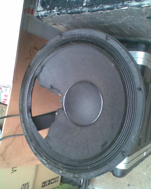

This is a PD186 or PD184, but never 1850.

Lol Embarrassed welcome to the club , did the same some time back , what cab was it in ?

What kind of throat was that driver firing into?  Curious as to how only one side of driver affected.

A Crocodile throat by the look of it, Hell that took a battering.

if it´s me you asking , It´s was in a hog , I think we gave them abit too much , they are V18-1000 I think they got about 2k each , didn´t feel to back to the lockup and get two more cabs , dubstep night , we were told there would be 600-800peeps there where about 1300-1400 so i just put more power into them
bad move , anyway they paid for it + hire for the night cool guys .

Rupe that def looks like a PD186 you have there......maybe where the problem arises from?
Nope, definately looks like a PD.1850 chassis and motor.... but it looks like a 'Frankenstein' job has been done on it... possibly a non-genuine recone? The spiders/spacer is bolted to the chassis, so definately PD.1850.
My opinion......
There are no long braids on a genuine PD.1850 as they enter the coil via the spacer between the spiders, the braids in the pic are very thin and have a little piece of cone stuck to ends of them, this means they entered the coil through the cone, under the dome.... the lugs on the inside of the former are covered in glue too, part of the non-genuine recone process.... the outer suspension (and whole look of the cone) is wrong, it is also dry and brittle, this means it's had the plastic coating, but has not had the moyen applied to keep it supple after being finished.... the dome is also the wrong shape.
Why I think this.....
I was looking over one of these today, took it back the factory - the production staff couldn't stop laughing. LOL

Yes, I see know. I judged on the cone, that just isn't from PD1850 .

Paul, im sure you warned me about these sketchy recone jobs ;)
Also
Is that a PD1851?

void v18-1000

so what was it pd1850 with a dodgy re cone? thats an impressive effort!
