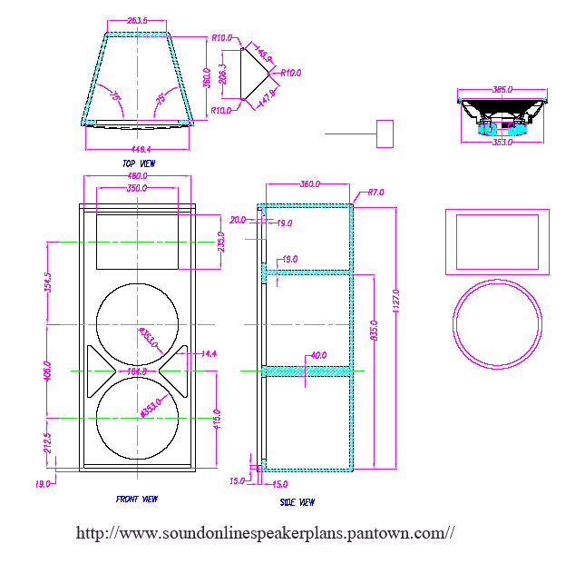

i did a search but couldn't find it.. are they're any plans for a dual 15" x15? or does anyone have some dual 15" midtop plans to share?

the x10 and x12 are dual models, prehaps you could just modify one of those?

15" 8/6" and 1/1.4" comp driver would work well
