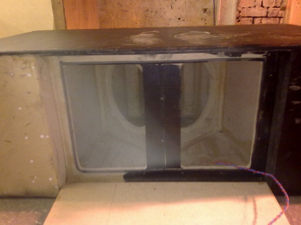

next, a random prototype of a double 12 push pull bandpass horn in a w-bin stylee, longer horn path than most bp horns, showed promise, sounded good but not very efficient and made a horriically wierd clacking sound when run at volume, think that mustve been the cones hitting the internal wiring, probably going to plug this back in when i get a minute in the next week or two and see what it's saying, if the clack is still there etc.
music is god
