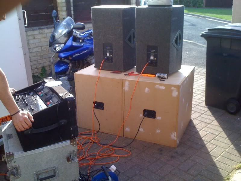

Hi all

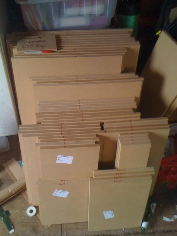

Right suppose its time for my first build.  gone down the mdf route.. mainly because its cheap yet effective and if i mess it up its not too bad. just have to be gentle with them and they might last me a year lol.
I have got the wood cut (no miters yet) and have enough to make 4 cabs. Couple of Emience delta pro 18 drivers i had spare which will have to do.
ill keep posting pics up as i go. Smile

well so much for posting as i go Confused

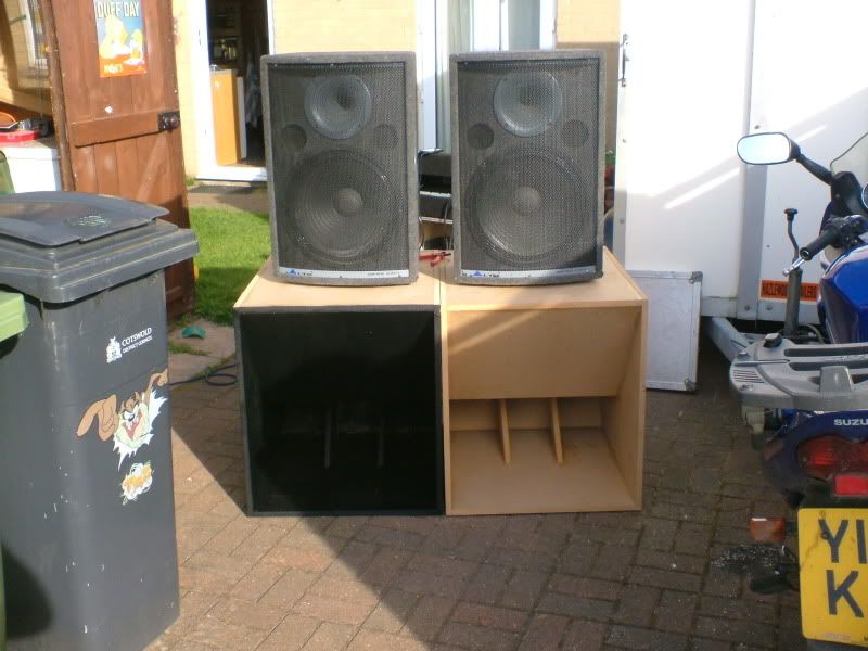

ill put the build pics up soon but ive already finished 2. 2 more to build and going up for sale.(dont need 4. much bigger than expected!)
wish i had listened to people though. MDF is awfully brittle and i cant see the cabs lasting a year of light touring :(

Looks good to me.
I would router the external edges if I were you, MDF has a tendency to flake if you catch it on a right angle.
If your careful MDF cabs can last a fair while, a friend of mine has got some MDF bandpass boxes still in use from 2008 or so used pretty regularly, just buy an extra tin of paint and filler to keep them looking in descent nick.

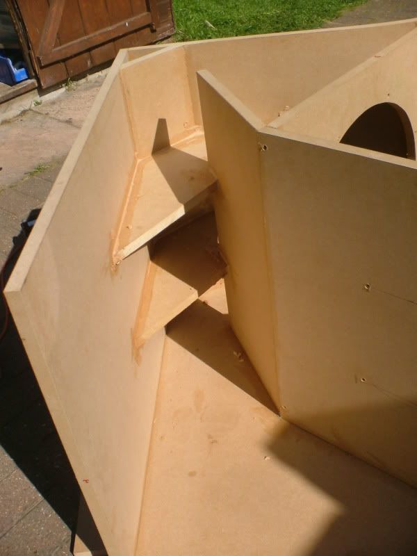

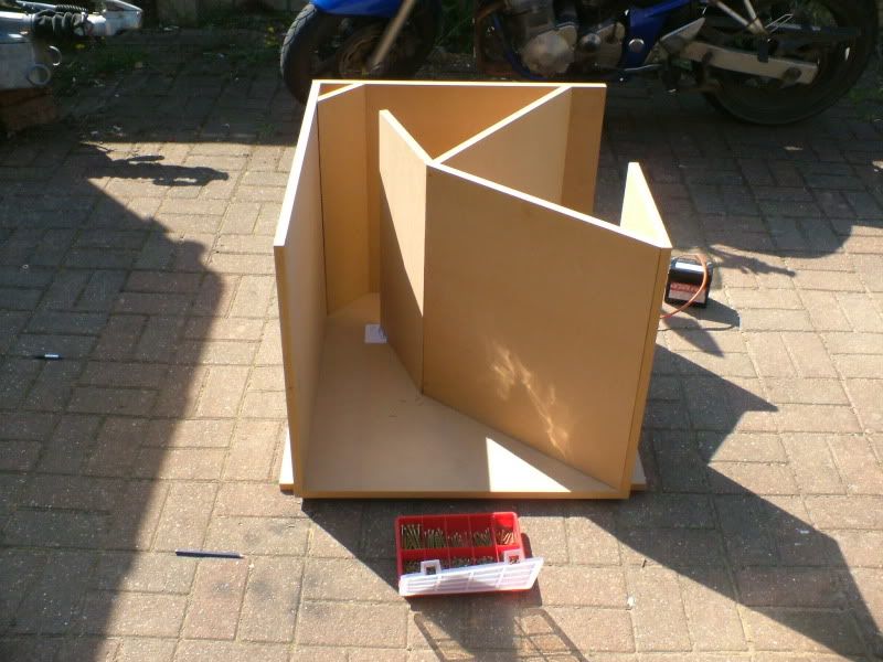

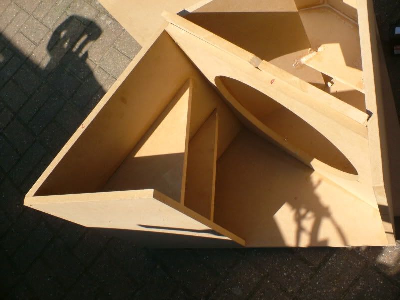

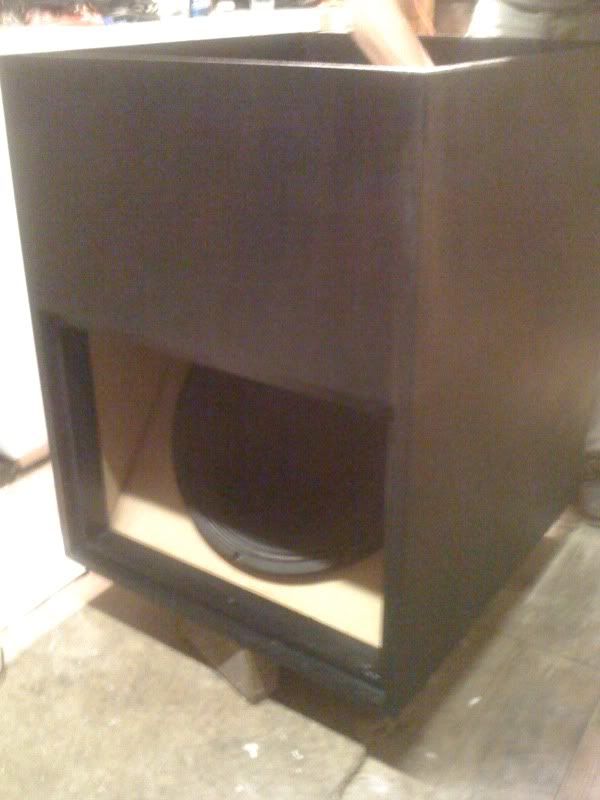

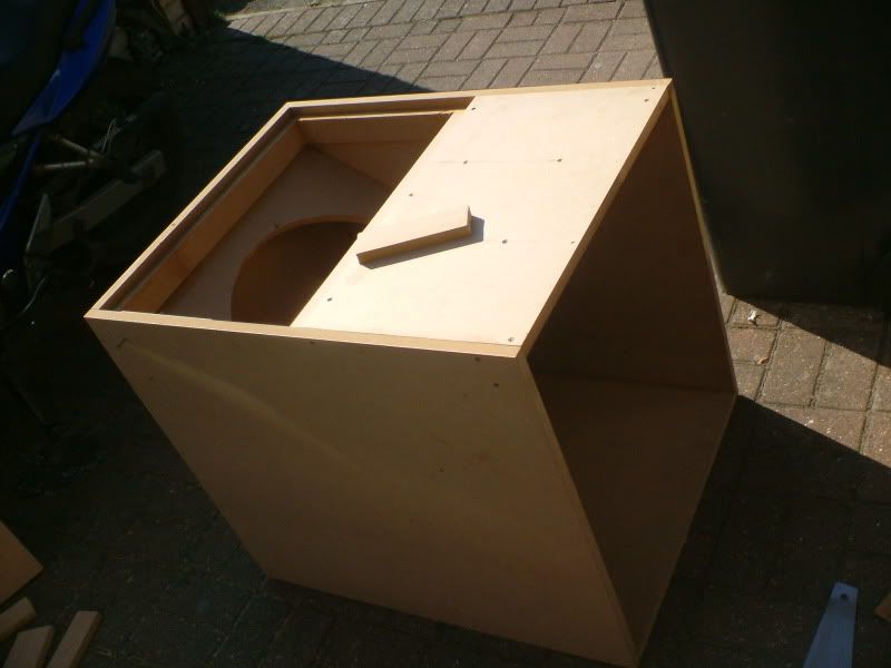

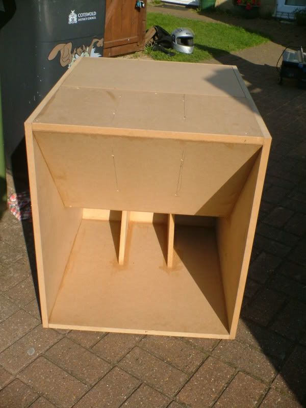

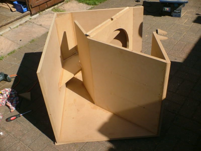

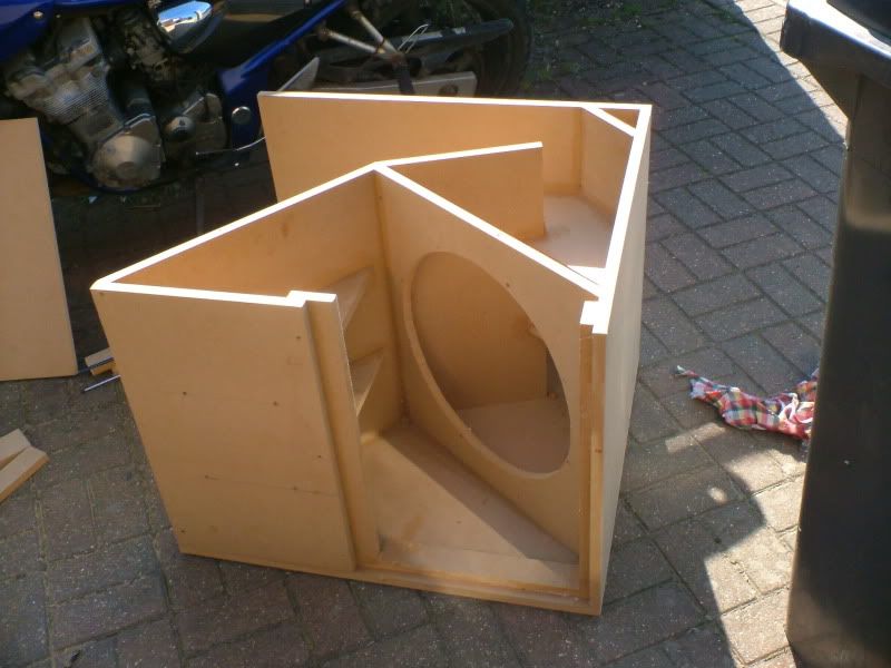

some build pics
Strange extra panel where the driver mount is, is a brace part that i had rested there. just clearing that up to save confusion.
its still sat there in this photo
friend tom doing some work for a change LOL
and my lovely new panels ive had made =D
More rackscrews in post Wink
what you think?
Edited by huntman40 - 09 September 2011 at 1:18pm

Post Options Post Options   Thanks (0) Thanks(0)   Quote Norseman Quote  Post ReplyReply Direct Link To This Post Posted: 20 September 2021 at 2:58am
im curious about the sealed chamber, and how to go about attaching the "door"
DMorison View Drop Down
Joined: 14 March 2007
Location: Aberdeen
Points: 1617
Post Options Post Options   Thanks (0) Thanks(0)   Quote DMorison Quote  Post ReplyReply Direct Link To This Post Posted: 20 September 2021 at 12:19pm
Attach a strip of wood or batten to the sides of the cab (and one under the back edge of panel G) below where the door will sit, mount your tee nuts to the underside of the battens, screw the door down onto those battens, preferably using some foam sealing/gasket tape in between.
This image I found via google shows 2 of the battens attached, the side ones have yet to be put in place.
