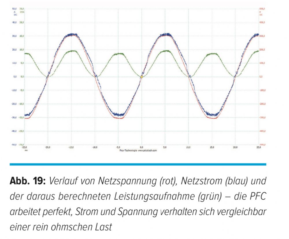

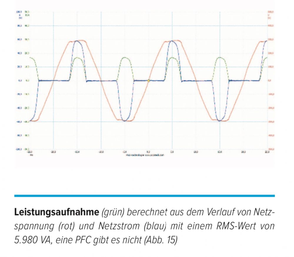

Seems not everybody is a fan of PFC:
Worth noting that in independent tests, two equivalent 4-channel amps with PFC achieved higher output levels (by up to 1000W) at higher efficiency ratings with music-like signals (12dB CF noise & multi-tone bursts).
The Linea did the best in the 10-second sine wave comparisons, by up to 360W or 1.96dB more output. This is all with 4x4 Ohm nominal loading.
This might also be interesting (Linea first):
For reference, I dug out a rare test of a modern Class H amplifier (Dynacord L3600FD):
The Dynacord is only 2-channel, but puts out the most on the sine wave 10-second test at 1225W. It does however only have a maximum of 600W of 'headroom' for the multi-tone tests and the music signal (12dB CF) tests. That's <1.7dB of dynamic range if you push the amp super hard.
Bear in mind that due to not having PFC, the Linea M series also doesn’t work on any input voltage mains supply. Instead it has two power supply settings, for either 110V or 220V that it auto-selects on power up.

wow I didn't know that about Linea amps, I just assumed they had PFC, they are correct that power factor near maximum load is most important.  Their document is a over simplified though! PFC is most critical in provisioning of generators, if you have perfect sinusoidal and in phase with the voltage current draw you don't need to over-provision.  A classical PFC stage however has generates a fair bit of current distortion even if it has 0.99 Pf, this can cause conducted emmisions test failure.
I have actually worked on 100kw+ power 3 phase PFC and it's non trivial, actual implementation required an SOC FPGA just to do the required control.  Its probably beyond the budget audio amplifiers.  If you do it properly however performance is sensational:   https://www.ti.com/lit/ug/tiducj0b/tiducj0b.pdf ;

Any chance you could post the links to where those graphs came from, looks interesting :)

They’re screenshots from my subscription to Production Partner magazine. Some of their content gets posted online:
https://www.production-partner.de/
