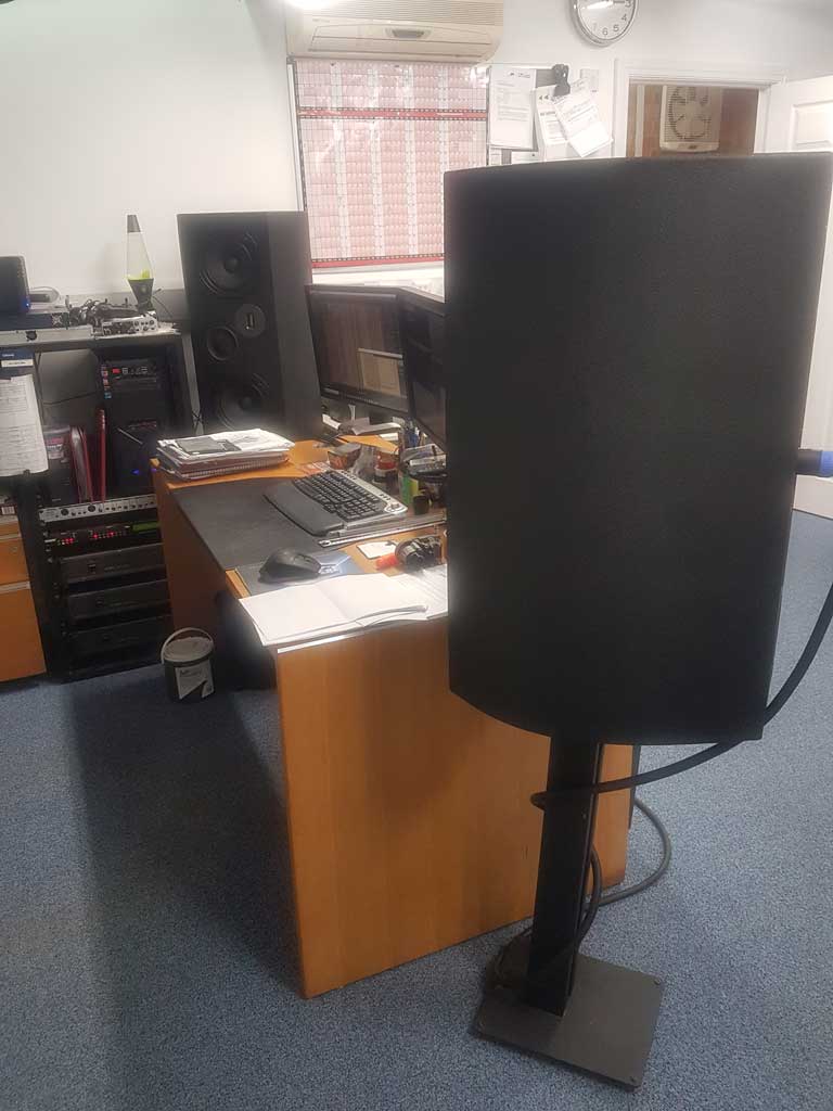

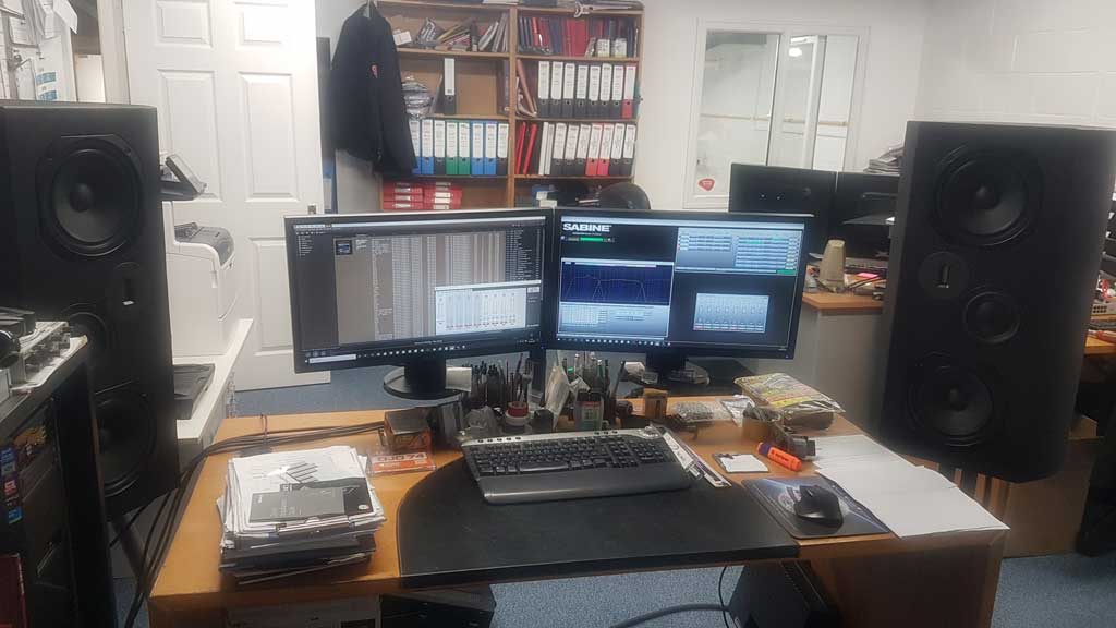

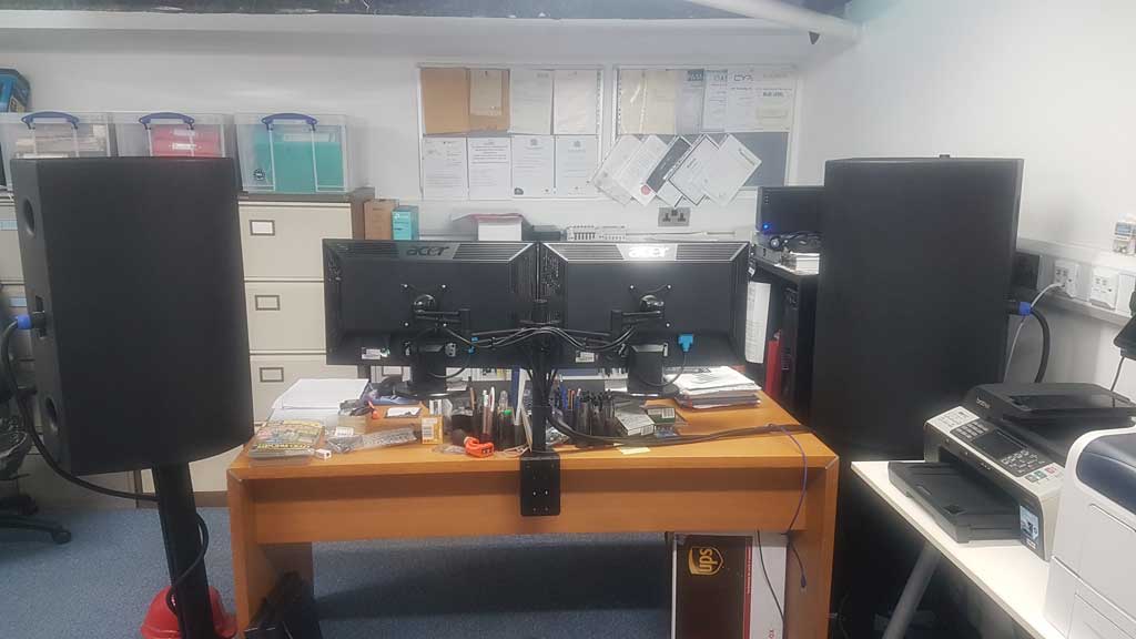

Some more in use shots. These bastards rock!

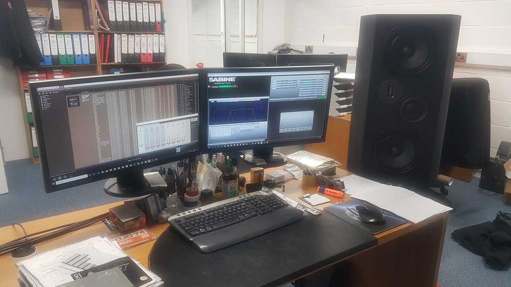

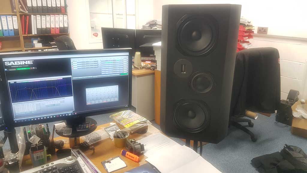

You should be able to see plot of DSP. All 48dB/Oct, 35-190, 200-3K, 3K-19K.
91Hz +3dB for a bit of kick, slight HF shelf from 12.5K, bit of roll off of mids, but largely flat. Just tuned by ear, as it is my ear which be listening!

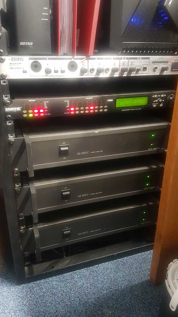

Amp Rack. I got the three Quad520C, along with a pile of JBL cinema cabs, for £150!! Recapped PSUs with original Caps from RS. V Tidy.
Sabine is 4x8, bitch to program from front panel, but has a RS485 control from GUI.

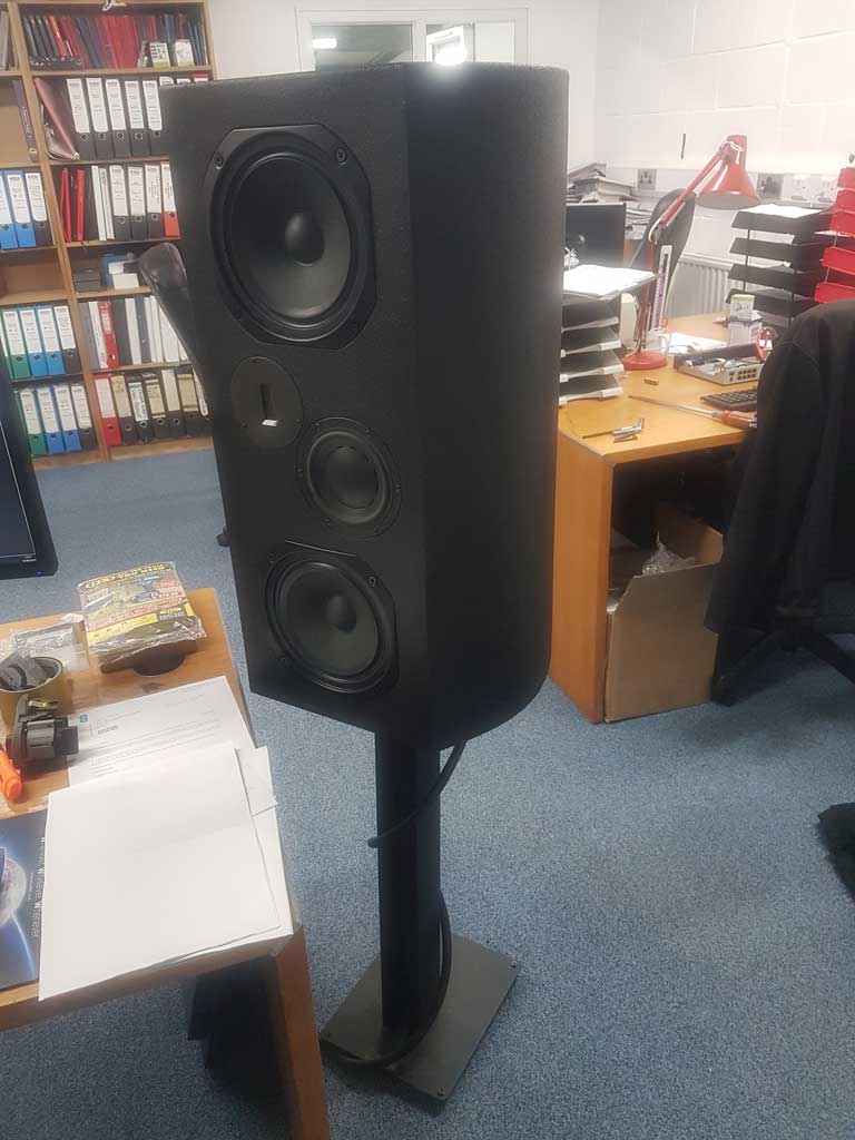

Rear: NL8, 8x2.5. Each bass driver has its own 2.5mm pair from amp to each driver, so effectively 5mm to bass. Ports are a nod to the late Windmill Tilter's preferred arrangement, which may aid convection cooling.
HFs have a large cap behind plate of NL8, effectively an out of passband HP 1st Order crossover, to protect against LF or DC getting to ribbons. Tried playing with phase to compensate for First Order shift, but couldn't hear any difference.
It has ended up that the HFs are almost exactly at my ear height. I hadn't actually considered it as a design goal, should have, but got lucky!
The screens are 24" to give you an idea of scale. The speakers are Big, aren't they!! Not bad for my first "from scratch" design and build!
These, now dialled in, have exceeded my expectations. No rattles or leaks, or anything to detract from the music, and seem to be happy with any style thrown at it. Gave them a damn good thrashing, and thoroughly enjoyed it.
For cheap drivers, the little wharfedales are brilliant, DynAudio needed to impress and they do, and the Fountek Neo's continue to offer cracking bang for buck, flat and detailed to beyond what my ears can hear!
I have found a pair of those original REL Quake 10" drivers down the back of the garage's sofa, the Sabine is 4 way able, and I have another 2x300W fanless mosfet amp kicking about....

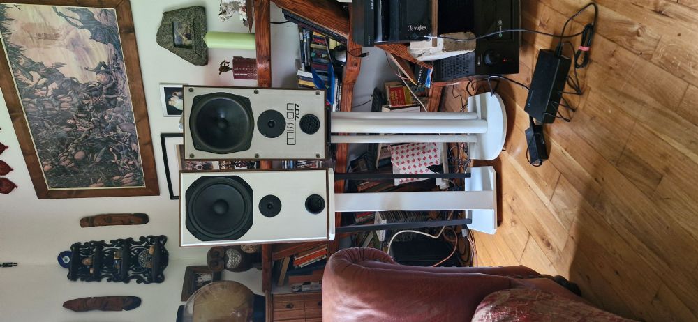

I recently expanded my hifi (ok, midfi....) to a 7.4.1 atmos setup and needed an extra pair of speakers in order to move them all round in order to replace the weakest link, the rear ceiling speakers (some no name 5"+dome). I was looking to buy another pair of mission 707s to match the front l/r but none popped up at a decent price.
instead, I decided to take a look in the darkest recesses of the shed in order to make something aesthetically compatible with the missions. I found the wharfdales and a pair of beyma t2030 (although these turned out to be too far gone to use). 20 quid later a pair of denon (jpw) tweeters, crossover and connection plate turned up. Sawdust followed and these emerged:
Still waiting on the logos (mine will read MISFITS 72) and feet but am generally happy. The raw sound is pretty decent and balanced, which is a bonus as they were built more as an aesthetic rather than purely audio project. Will be interesting to see what eq audyssey feels they need when I finally get round to tuning it all

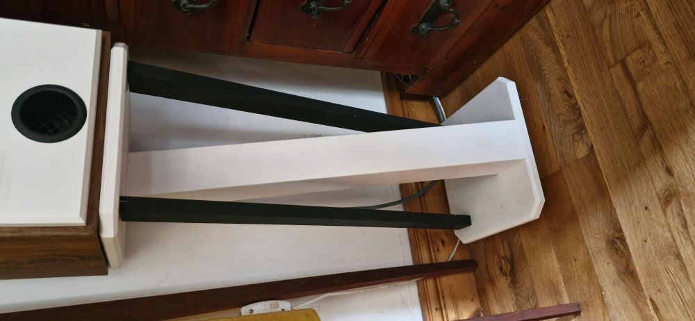

While Im showing off, Im rather chuffed with the stands I made too
