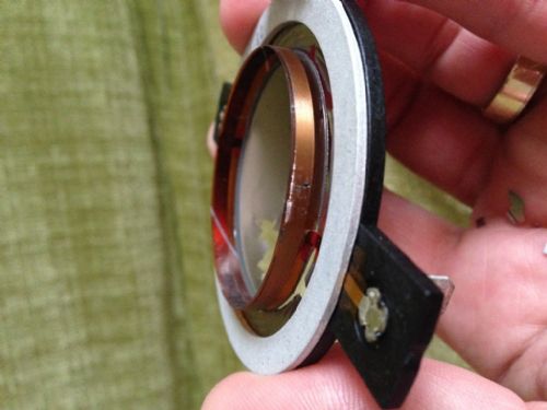

After few years of running this lovely system first damage occurred. Xtro settings set as in plan.
Any idea why this happened? Amplifier used QSC RMX850.

Too much stress. Feedback??  Amp turning on/off thumping?? Do you use a cap ( 10 - 20 mfd) between the amp and driver??  VECTORSONICS

Coils not burnt.  Looks like metal fatigue/old age?

I have had this reoccuring on some Tannoy V15i cabs. They are run passive, but part of a active 2 way FOH.
DSP is set exactly as per settings in manual, and has look ahead limiters, and huge amount of limited headroom on amps. My opinion is low res mp3, rich in unnatural harmonics, creating square waves at HF.
Either that, or the Tannoy designed and built X-over's are crossing at too low a frequency, or at too low a rate per octave.
I would expect similar from these identically failed diaphragms.

Coil is absolutely fine. Maybe switching off other equipment first instead of amplifiers? Not expensive repair, but still... Speaker is 5 years old.

Possible equipment switching on/off before amps. And no, no cap used between. Ill probably add them.

This damage is typical for a diaphragm that ran too low a frequency.

Even when crossed at 2500Hz? Using DCX2496.

Maybe, what slope?

Some amps chuck out some DC when switching off.   Crackle and pop are some of the sounds.

Which is exactly why i run all of my HF drivers behind a very big (Fc at least an octave below intended Xover frequency) MKP capacitor.
