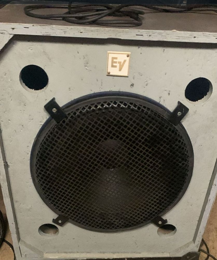

Friend of mine has a couple of these old beasts kicking around. The brochures of yesteryear available on the net don't provide any parameters, probably because they predate the work of Thiele and Small.
Does anyone on here have a vague idea of the xmax and xvar/xmech of the 18 HP? Iirc they claim 25 Hz resonance Shocked
Any input would be highly appreciated!
Power wise I am aware that they are frail, they will be driven with suitably specced amps (100-200w rms @8 ohm)
Apologies for the bad picture. Hopefully you can glean something despite the grill.

Post Options Post Options   Thanks (0) Thanks(0)   Quote jbl_man Quote  Post ReplyReply Direct Link To This Post Posted: 04 January 2025 at 1:26pm
Goodmans 18p has a paper cone, and a doped paper surround. Xmax is irrelevant with these. Power handling was 100 watts at best, and given fifty-year old adhesives, 50w would be about the limit today. 3 inch voice coil.They are quite efficient for an 18-inch though. Was mainly intended to be a bass guitar/organ speaker, so has some useful lower-mid sounds.
 I did buy a couple of these new around 1976, were only about £45, those were the days!

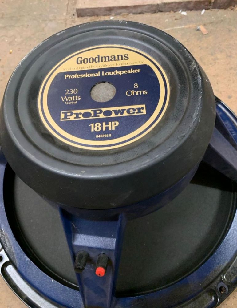

Here is another picture. They are Pro Power  series HP 18
Anyone care to share actual experiences of using these, what they are capable, what are the limits? For example, is there a risk of easily damaging the voice coil former with overexcursion?
Does anyone know the dimensions of the voice coil, clearance from the pole plate etc........
I remember talk about using these in quad wardrobes, run off 600w kt88 tube amps..... they must move some air?
Edit:  and furthermore, are these the frames people talk about being reconed by wembley speakers?

Post Options Post Options   Thanks (0) Thanks(0)   Quote jbl_man Quote  Post ReplyReply Direct Link To This Post Posted: 05 January 2025 at 9:01am
That is the later model, the one i was refering to was the earlier 18p.  The one you have would have been mid-80s.
Yup, higher power rating. Will still be the same 3 inch coil i expect.
