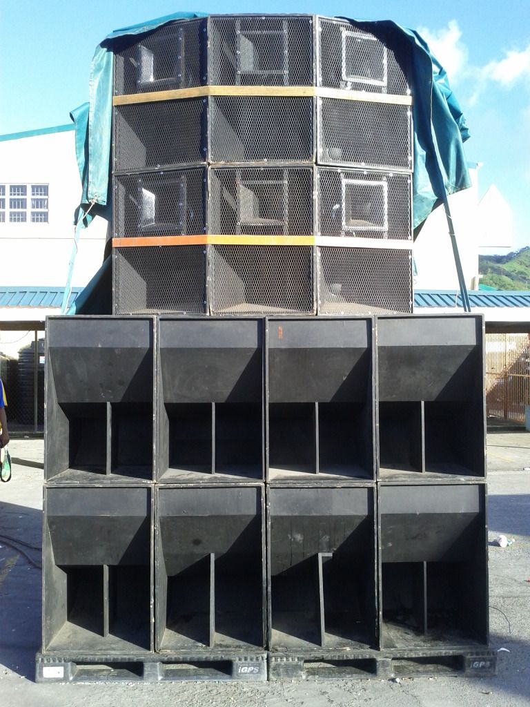

Thanks But this setup also kicks some serious ass with six or eight 186 bins as well.

 Hi, are those mid tops your own design have plan for them would be nice.

no i dont have plans for them sorry they were built by a local speaker builder who has the plans.

Mid high cabinets looks like  the SMT212

I'm also interested in the tops, but they're not a SMT*12 design...

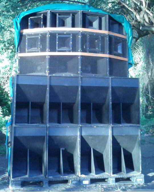

@5 &, can I have your opinion on the two types of stacks in the pics......scoops vs 1850 horns essentially......thanks.

just curious anyone ever stacked the bottom bins upside down so all mouths are coupled??
any opinions?

i don't say that they are SMT212 designs. It looks like. The horn of the high freq. is taken of and placed inside de double 12 mouth.
Before i have made also the SMT212 only the 12" part with coaxial speakers inside.

the 186 horns will have coupled just fine in that config, the horn mouths are well within 1/4wavelength haha [bearing in mind the horn mouth is right the way to where the angled section hits the panel fronting the rear chamber.
and i love the dual 12 + comp midtops, the way they array looks good, long as the comp flare dispersion matches it - would be interesting seeing their plans. Are the row of single 12 and comps really necessary on top of them though, seems a tad overkill and would have some possible drawbacks which outweigh the advantages, maybe a less is more circumstance. Either way, i bet that sounds very impressive, especially with the 21" scoops, very well thought out system Thumbs Up.
