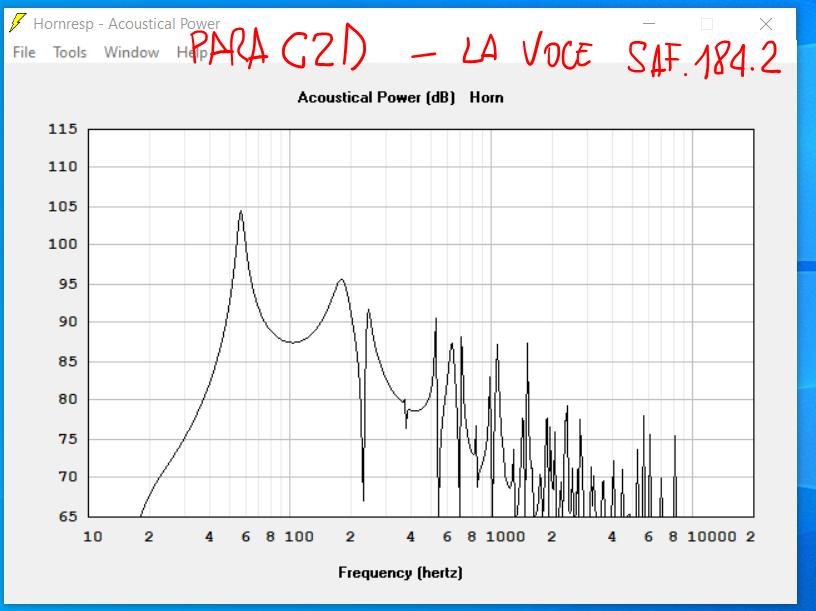

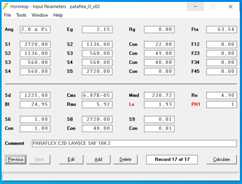

Hello everybody!
I'm going to build some Paraflex C2D 18" as new kick for my sound, them will be on top of Paraflex cram type O 2x18,.
Right now i have g-sub and mogale superscooper 18.
I did a test in hornresp but the graph is a little too spiky around the 60hz, am i doing something wrong in terms of input parameters?
Thanks alot!

Hi !
Trying to Hornreps my own Paraflex these days, but there's so little information on how these should be translated to Hornresp..
Did you figure out how to properly simulate one ? Could you help me out ?
Mistral
