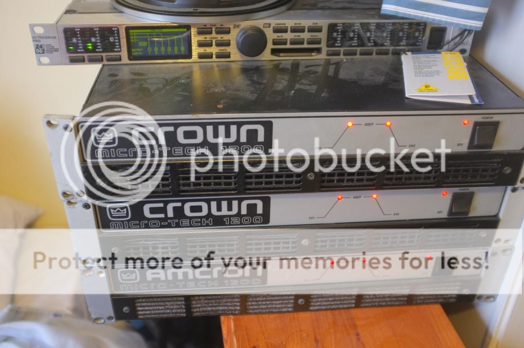

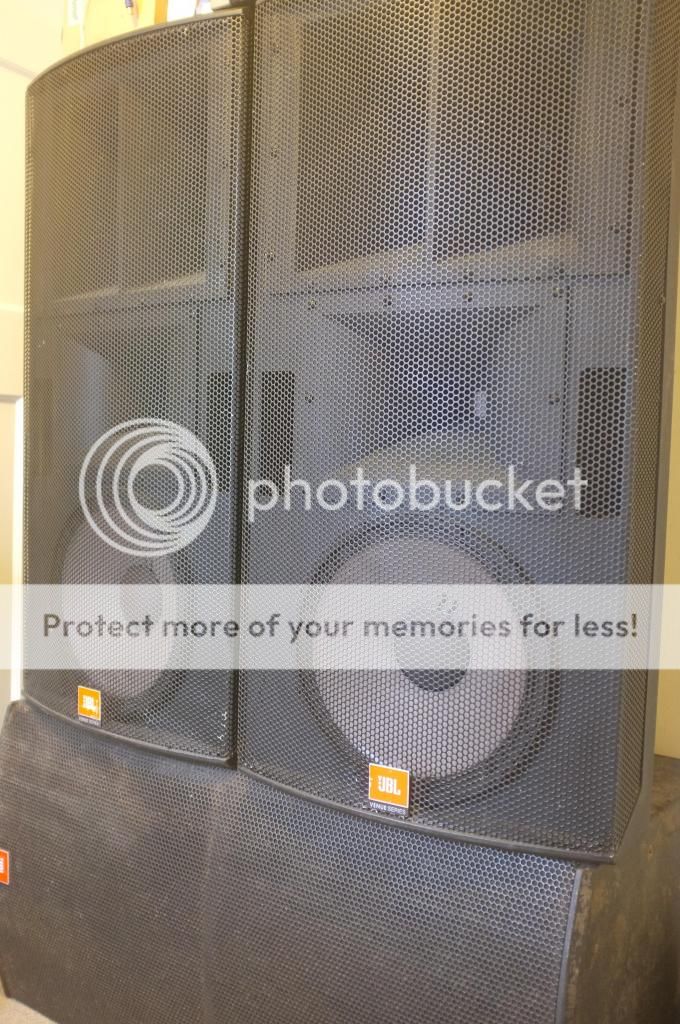

Hi, just thought i'd share with you my bedroom set up. Consists of : Pair of JBL VS215-6 http://www.jblpro.com/pub/obsolete/venue/vs3215-6.pdf Single horn loaded JBL VS125HS http://www.jblpro.com/pub/obsolete/venue/vs125hs.pdf All with original drivers. Three Crown Microtech 1200's and a Behringer Ultradrive Pro. All set up to the correct JBL Venue Series Tunings. High Passed at 38Hz (VS125HS run on the same channels as the lows of the VS3215-6's in discreet mode) Very nice tight mid bass. JBL 2227's are excellent for this. The VS3215's were dismantled to reduce weight when carrying upstairs 75kg! Edited by shaun1264 - 06 September 2013 at 12:49pm |

serious stuff for a bedroom set up

How big is your bedroom? And how far away are the neighbours?

... splay
... comb filter ... yadder yadder yadder |

None of that matters much when direct sound is only 2 feet away from your ears.

I was waiting for someone to mention comb filter. Listening distance is about three metres away! Certainly room filing sound. The loudest I go is around 100dB. In an average sized bedroom that is loud enough lol.

You will find that with sound, a lot of it will subjective and like a lot of theory, things have to qualify, however, the clever bit is knowing what really matters and what doesn't. Sometimes theory will differ from real life ( or Live) situations.
If we all took notice of theory, a lot of stuff wouldn't reach fruition. In any room. You will always hear the sum total of the room if you are sitting a distance away from the source.

is a shame not to have it in stereo though |

Hi, I haven't yet ran it loud but the neighbours have noticed. . But around 100dB is fine for me. I have the gain down low on the input of UltraDrive. The sub can knock out 139dB and the tops around 132dB each. I doubt I'd ever get to those levels. Lol. The speakers are run on each side of the channel amps. Stereo but not true stereo. I bought the amps several years ago as singles. Took me a while to source them. High damping factor and good old Crown quality heavy iron. They have run many speakers of mine in the past from those ugly EV SX500's to a pair of Turbosound THL-2's.
The bass is good fast tight mid bass. Nothing to shake or vibrate, but its a decent sound where each bass tone can be differentiated. The VS125hs sub freq curve shows not much output under 50Hz. The only problem I encounter is bad interference from my computer monitor transformer. I'll have to try a seperate electric point to remove the sound. I may swap the bass out for a 4785 (see other topic of mine) which I'm refurbishing. |
