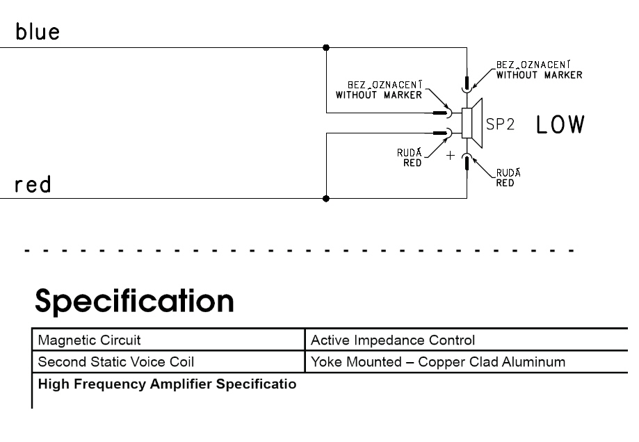

Just had a client describe his 18sound driver in his KV2 speakers (EX12 tops) and mentioned a second pair of wires for the woofer. I had not heard of this before and it's shown in the diagram.
Does anyone know what this is? I've posted a snippet out of the manual.

Active Impedance Control (AIC) like the 18sound 12NDA520 probably.

Interesting, 18sound have an AES technical paper on the website. Mostly went over my head TBH
