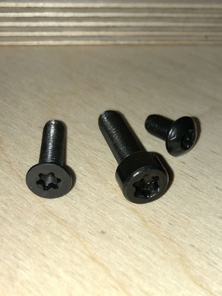

Received some torx head bolts I had manufactured.
A4 stainless steel black passivated.

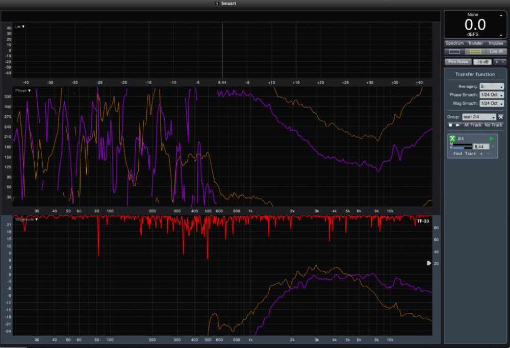

below is the measurement with no filtering (orange) and filtered and 2 eq points (purple) of the HF unit.

Thank you. Looks like a good match.

Very neat, I like it. Are you running both 5" drivers up to the crossover to the comp?
What eq did you use? Is it a high shelf boost and a parametric cut lower down?

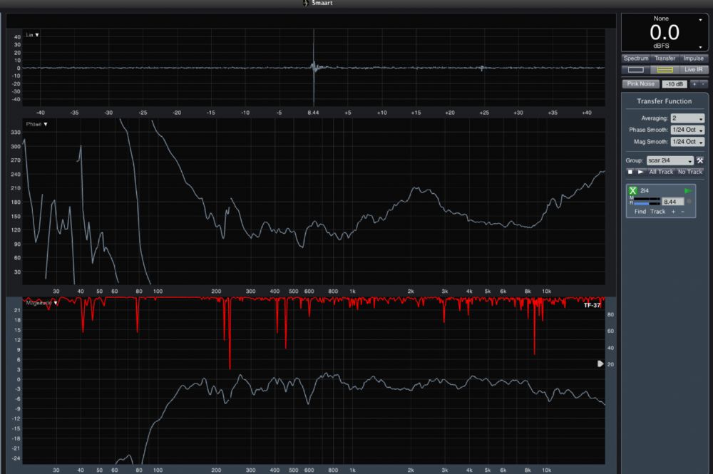

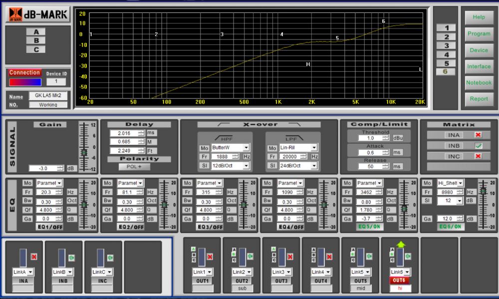

Thank you.
Yes, both 5" drivers are going upto the comp.
Using a parametric cut and a high shelf boost
No Eq on the 5", the LPF doesn't meet the 1" HPF; found a slight gap improved the response and phase.
The 5" & 1" together
