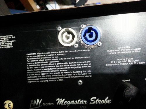

Depending on how confident you are you can mod' the lights to have power in and link connectors.
This is what i have done on my own lights.
I run a DMX and PowerCON up using Van-Damme Ambicore type cable to the first T-Bar then link this out to the next one. Just have to be careful it doesn't get overloaded.
As others have said this is quite an expensive way of doing things.
A 4 gang extension or IEC splitter as you pictured is a much cheaper way.

Bigger lights... daisy chaining with in/outs for power and dmx is a very good idea providing you have a rule of thumb where you wont daisy chain more then 4 at a time if old skool hid lights.... the idea of daisy chaining is superb. Just thing about the power draw on the 1st effects main power feed.
that and doing it on anything like parcan36 is gonna be tight.

It can get very tight, very rarely do we get a chance to link lighting stands. Just not worth the risk, especially as you say the load one the first fitting if the soldering isn't up to scratch cause a fire.
It is very neat though, really does clean up the rig.
Another way of doing this method but on very low power items, LED and such is to use one of these costs the same as a single panel mount PowerCON connector.
http://www.rapidonline.com/Cables-Connectors/Push-Fit-IEC-Inlet-Outlets-63592
PowerCON link using 2.5mm H07 (Doesn't have to be, but personally best option for cable) are also needed and they are around £13 for meter link where as a fully made IEC are about £2-3 each.

Put the effort in and you could do it yourself! Its just wiring...
Few metal junction boxes with dmx in/out and a power socket. Shouldnt be as hard as it sounds.
Confused ... try one of these instead of a holesaw next time .. much neater
