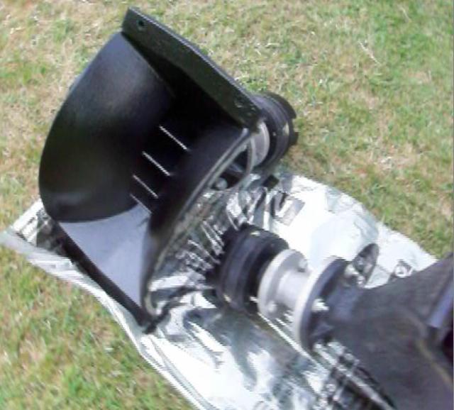

Weird those are fitted with Pa75-314 looking at the photos...those being the bass version,i would have thought the pa75 std with the ally dome would have been more in-keeping with the RCF original sound. Not sure about the eminence hf driver, that deffinately needs to come out.
Interesting,the horn flare is the standard martin HF2 modular series horn, with an adapter bolted on the back to mate with the Emilar...remove that,and you could bolt a 2"exit big-boy driver (2441/2445 etc) straight on, but would, of course, make the already heavy cabinet even more so. Would be very loud though!

Yes Ian, the emmy 1"ers will be coming straight out, and fitting a larger driver is a good shout. Ill probably go with a 2-1.4" adaptor and probably a nice Neo RCF 1.4" which should play nicely from 1000Hz or so. The HF2 should support that, and if these are long coil ATC's ( which they look like) then they will appreciate the lower x point. Bi-amp will also be the way forward, so the filters, which already look meddled with will most likely come out. That will improve the phase response and the weight!
