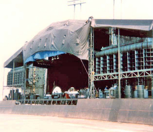

Here is a photo of Delicate's rig that they used for Supertramp.

Great picture there, I have never seen that many Martin boxes in 1 place. I doubt they knew how close they were to modern system coverage, just had to rotate that hugh line of 212's and HF horns 90 degrees to get pretty close to a modern J-hang and stack all or most of the 215's across the front of the stage in a sub array of some type.

That stack of 215s! Kick much? Wow.
Interesting application of the philishaves.
