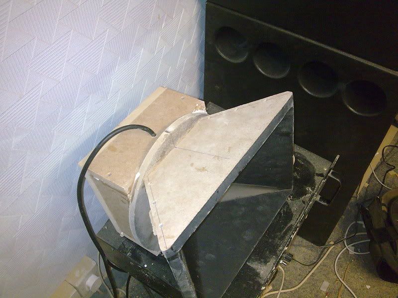

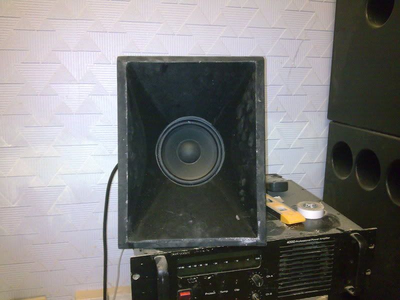

the small upper mid horn:
Based on dimensions of Limmer 042 6" section, with dressed polyester filler compound in the corners a la MX600. Didn't even take that long.
witness the ruffness

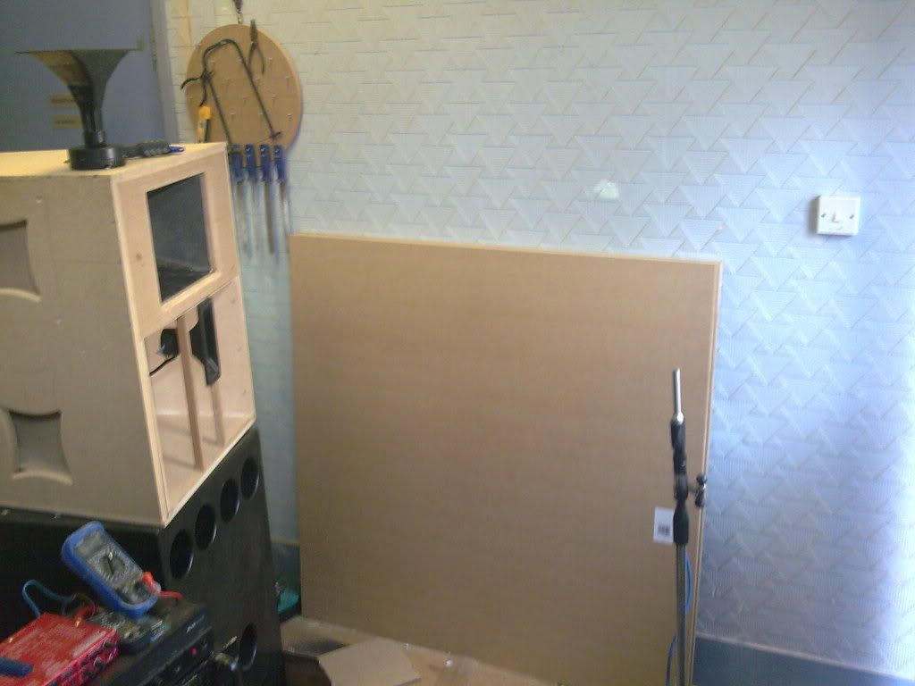

The front of the cab as it is now. The piezo horn isn't staying, but crossed in at 7k, actually isn't bad at all.
The full stack, including 184Sub.
No drastic gaps in frequency response i can hear...Have yet to measure it.

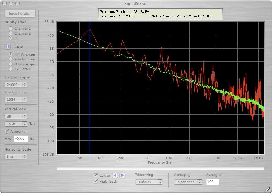

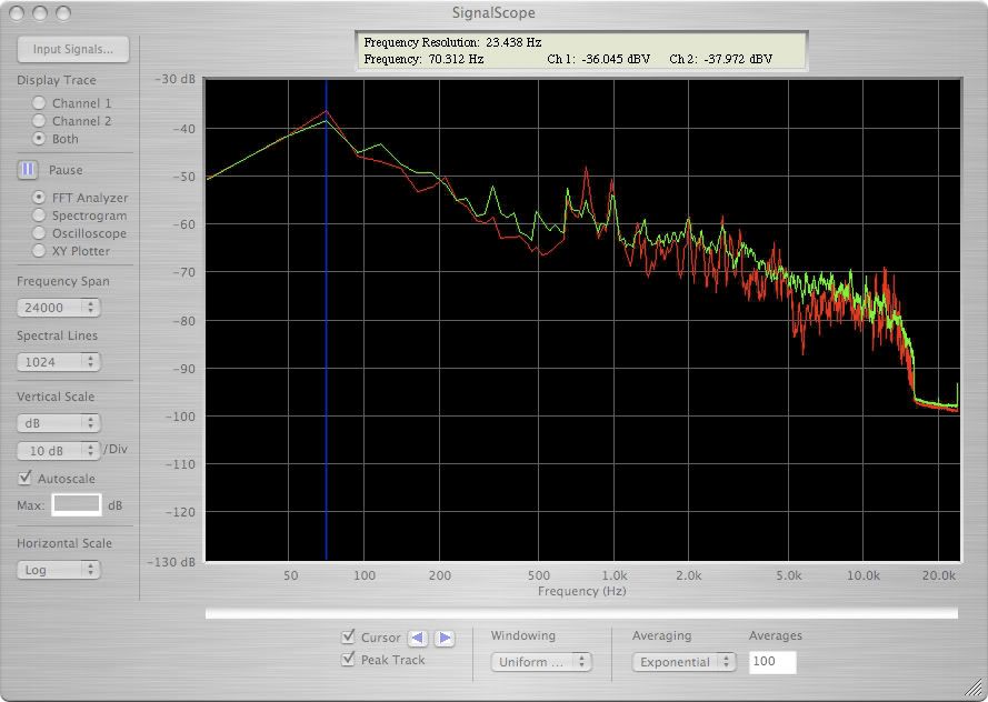

I have plots...Red trace is mic, green trace is reference
With pink noise
With music program (some old school dub):

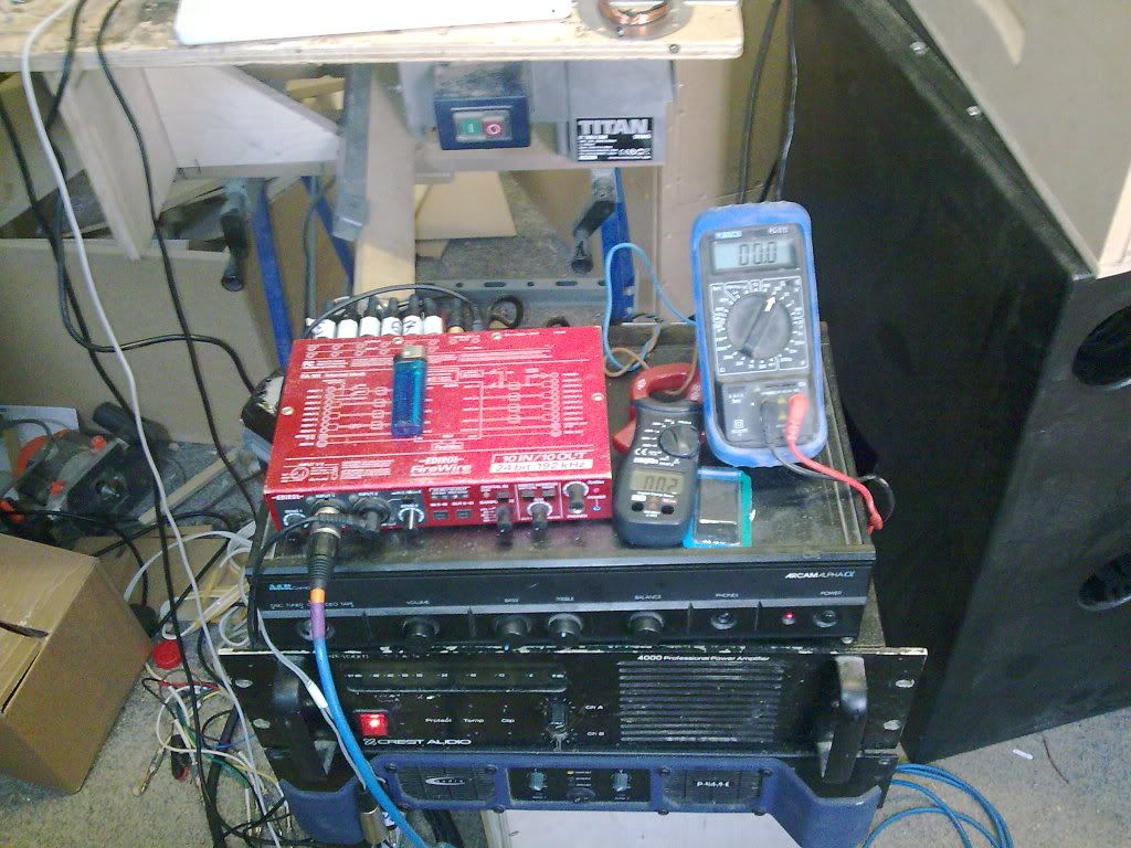

The measurement setup:
That's a Behringer ECM8000 measurement mic, a metre from the cab, in a totally acoustically untreated room (workshop). Dunno how this will affect readings. But it sounds pretty good once I'd used the measurements to adjust a GEQ in the processing software to get it flatter. But then , to me, it would :)
