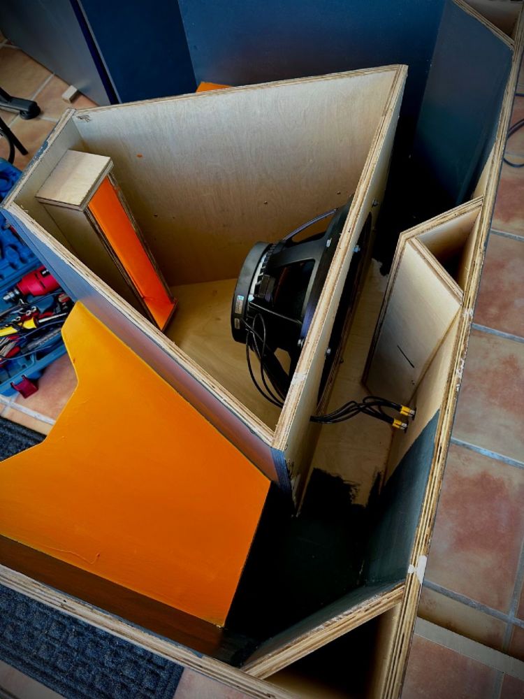

Hi there,

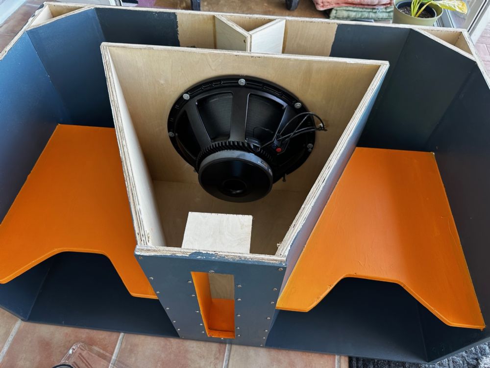

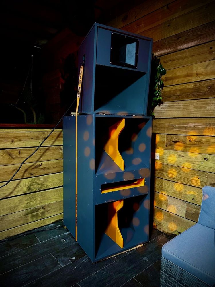

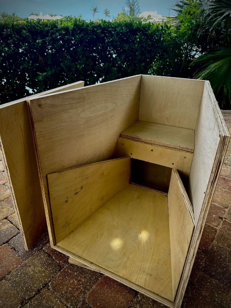

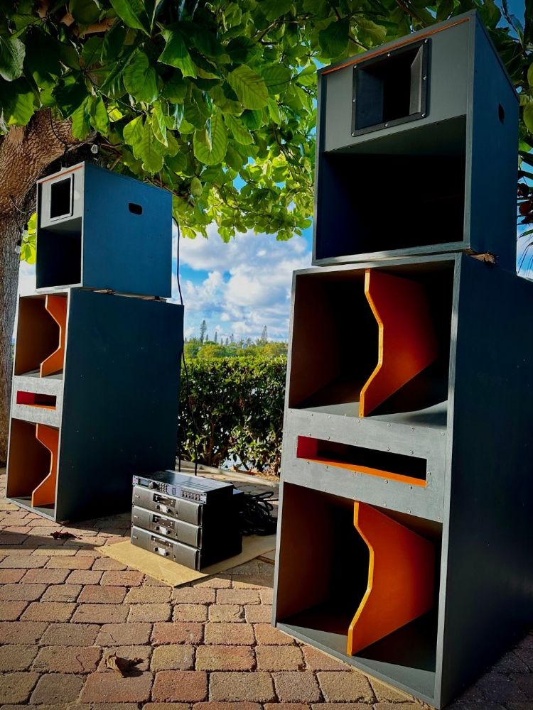

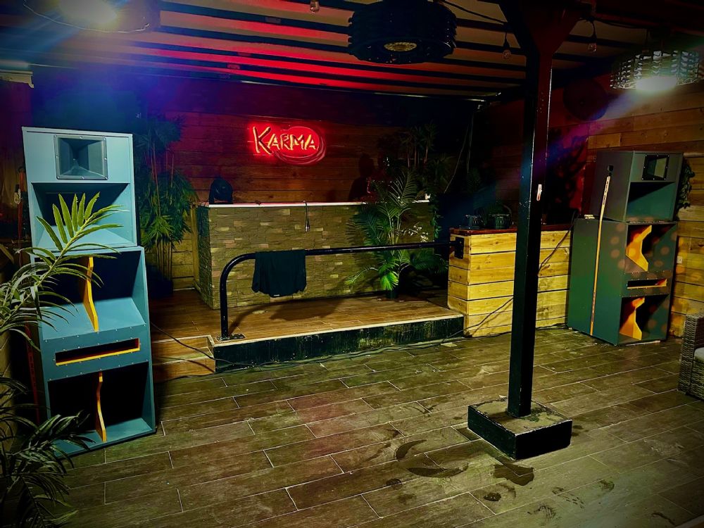

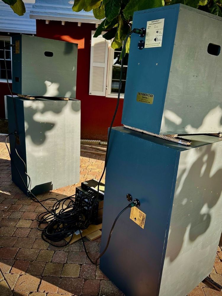

I recently completed an MT121s and MHB4818 build and thought I'd post a few pics since there doesn't appear to be much recent activity on this forum on this topic. I also used them for their first public appearance this weekend at a local club playing mostly house and techno. I knew they sounded good from the testing I did at home over the past few months, but I was absolutely blown away with how well they did in a larger space. They really need space to breathe (which they didn't have in my little sunroom at home). So much power, perfectly clear, and not exhausting to listen to at all (of course lots of this has to do with correct programming/tuning). Really happy with these overall. Drivers are the recommended B&C (DE85TN-8 for the highs, 12NDL76 for the mids) and RCF (LF18G401 for the subs). Powered by three NX6000s (L, R and subs). Run by the dbx Driverack 260. I know I had a million questions while building and there was very little (especially recent) info out there, especially on this forum. Instagram isn't bad for build pics, but you aren't exactly discussing the build on insta. So feel free to ask questions here!

Hi mate, I'm building a mt121 as you have, can you tell me what the angles are you have used on the front and back of the left and right inner 12" horn panels? Thanks
