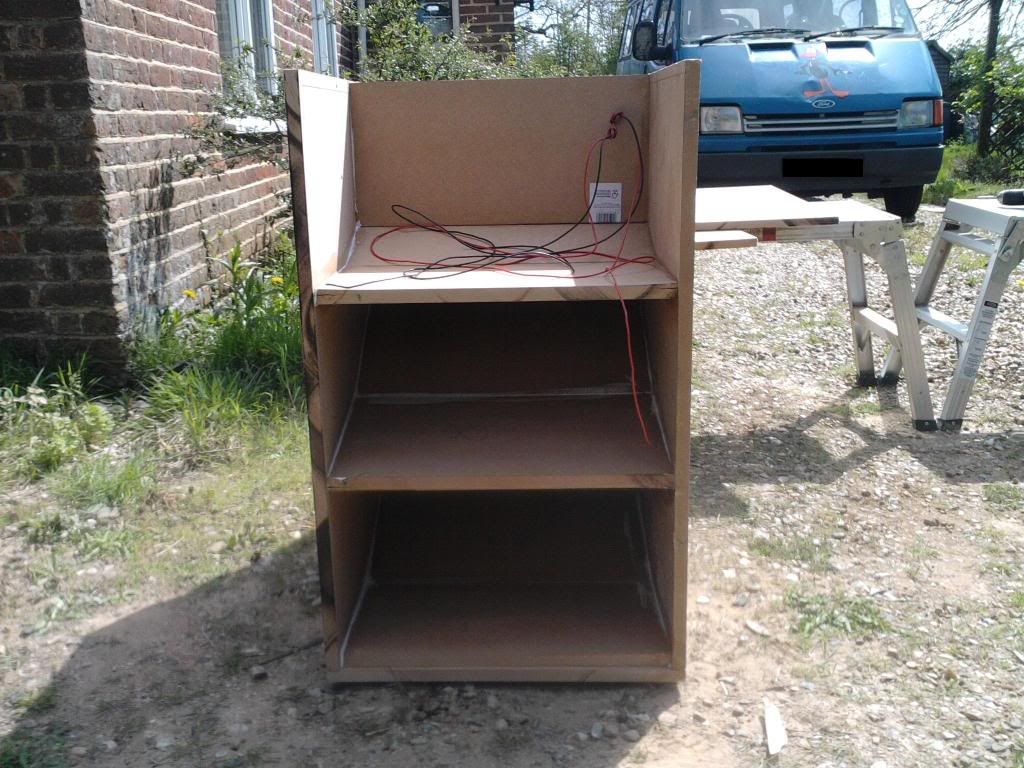

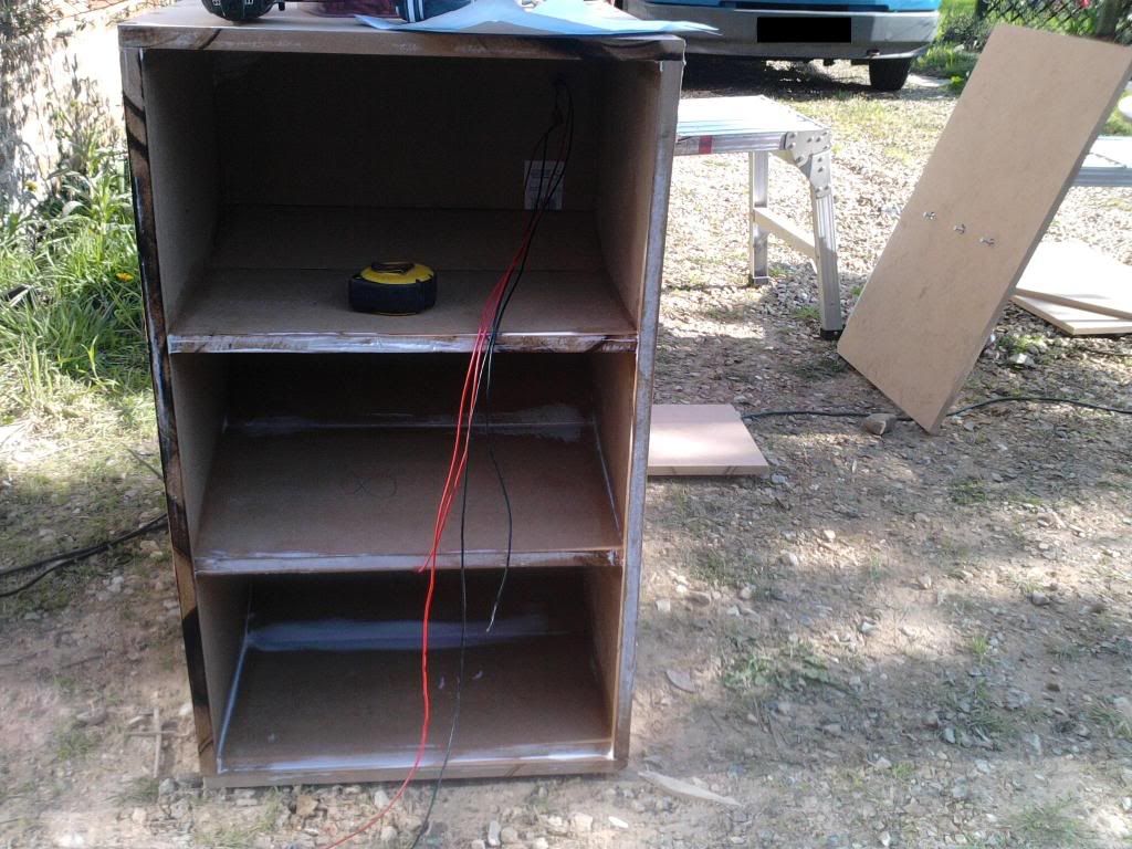

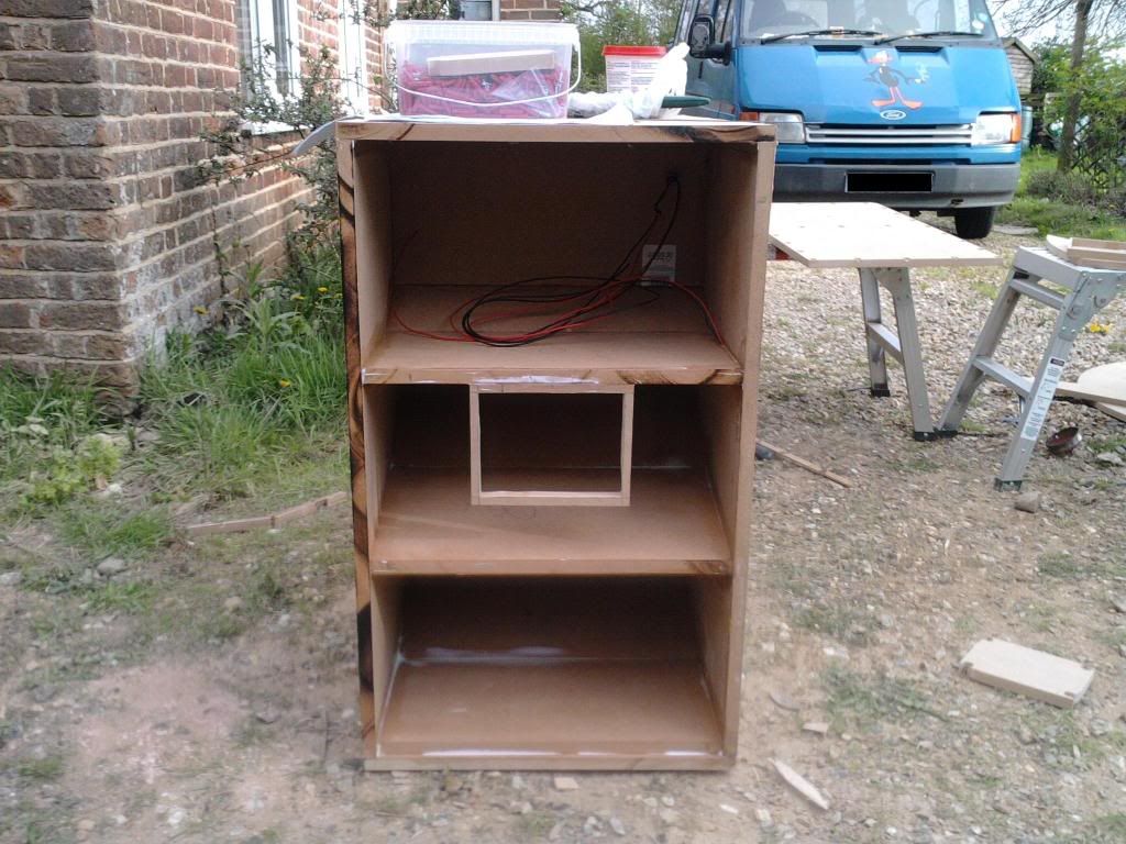

pic update
![]() ![]() ![]() ![]() ![]() ![]() ![]() Just waiting on the XT8 Horn, 8" and 1" driver and horn.
Rengade Project
Joined: 12 December 2004 Location: United States Status: Offline Points: 601 |
Posted: 19 April 2009 at 2:03am |
It is coming along well ! You should do a cutsheet.

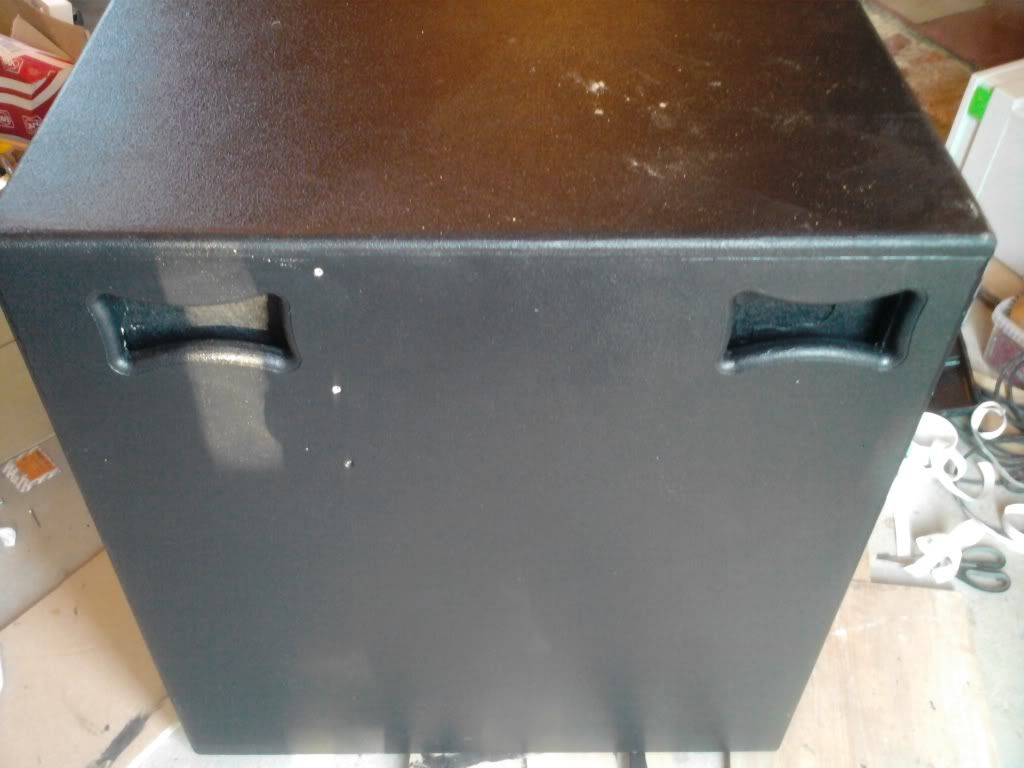

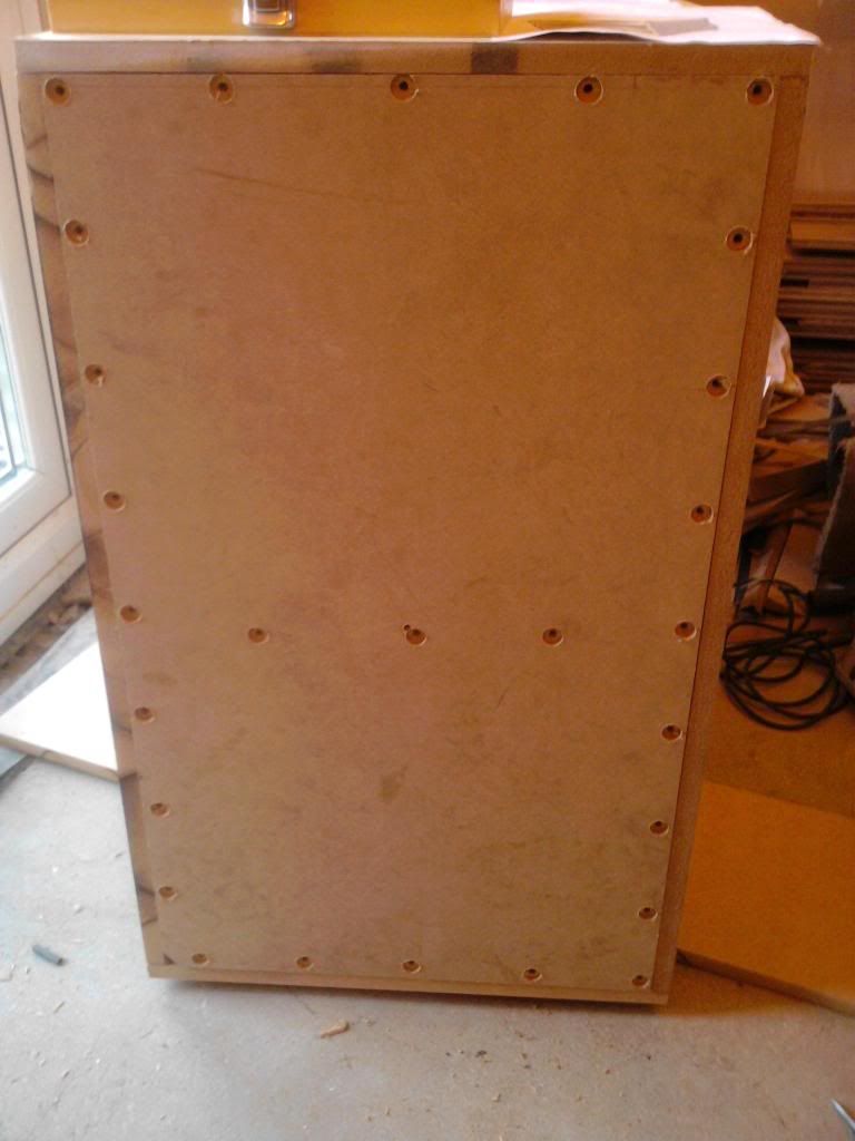

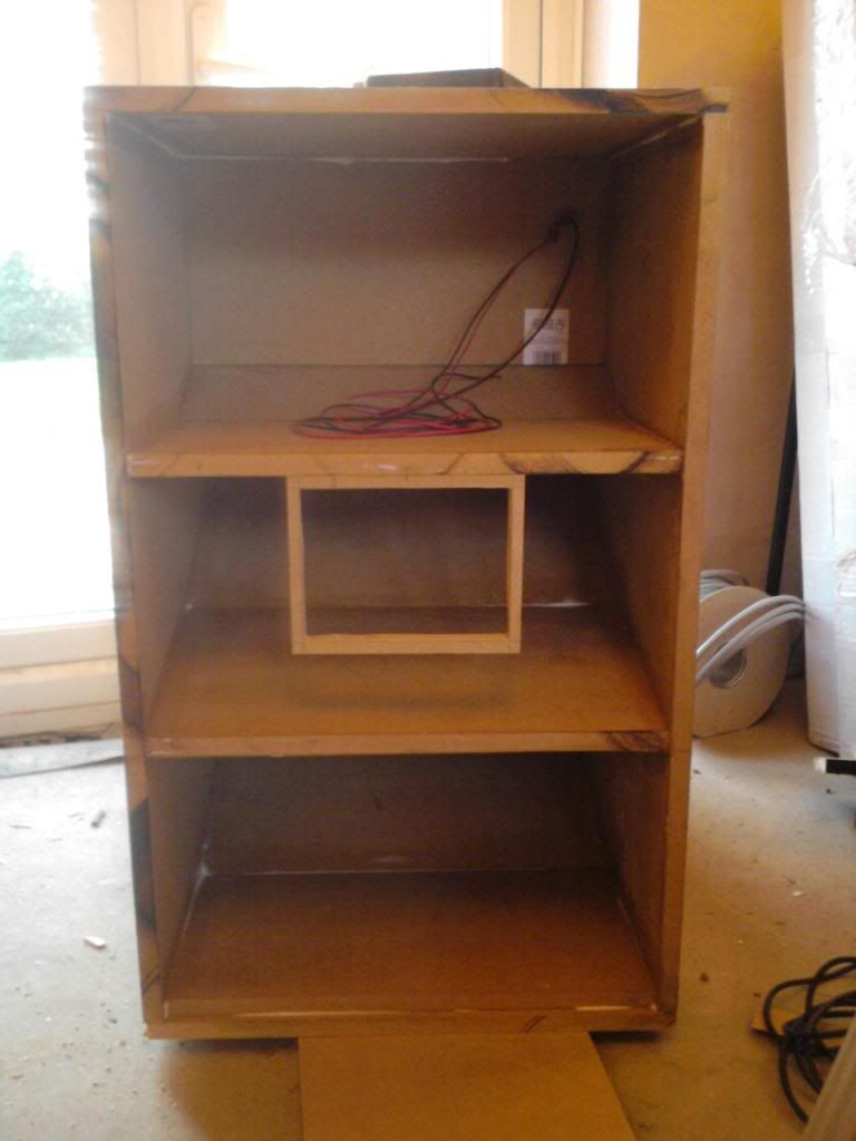

A few more pics,
![]() ![]() ![]() ![]() Now all i need is the drivers and the mid horn, unfortunatly gotta wait till the 16th of may for the drivers bit annoying but hey. Still haven't decided how to wire them yet, was thinking of using an 8 - pole speakon and using the 2 spare pins to feed the subs, that means only having to run 1 cable to each stack.
jonminns
Joined: 13 April 2008 Location: United Kingdom Status: Offline Points: 1877 |
Posted: 25 April 2009 at 11:44am |
Looking good
NL8 is the way forward, would be a disaster to get hf and lf mixed up! |
mykey
Joined: 18 August 2005 Location: UK/Indonesia Status: Offline Points: 9680 |
Posted: 25 April 2009 at 2:04pm |
I wouldn't say it was an attempt good stuff looks like you have used 18mm? |
MessyM2k8
Joined: 29 October 2008 Location: Norwich Status: Offline Points: 690 |
Posted: 25 April 2009 at 7:58pm |
yeah i was building this one on the cheap and had a couple of sheets of 18mm mdf laying around so thought i'd use that. Makes it quite heavy, but this ones just a test to see how good they sound. Can't wait to get the mid-horn and drivers for it. The bass section sounds ok, gave it a test earlier, i've got it loaded with delta pro's, gonna try some beyma's in it when i can be arsed to pull all my speakers out of the shed. Anybody got any news on the XT8's? are they available yet? |

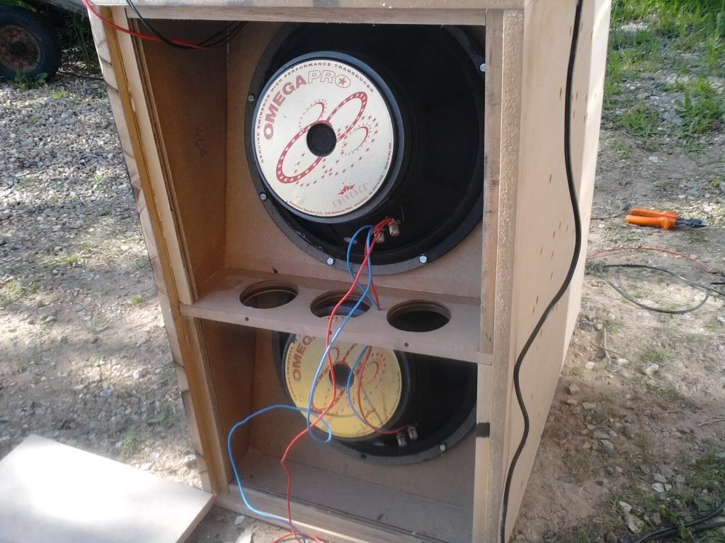

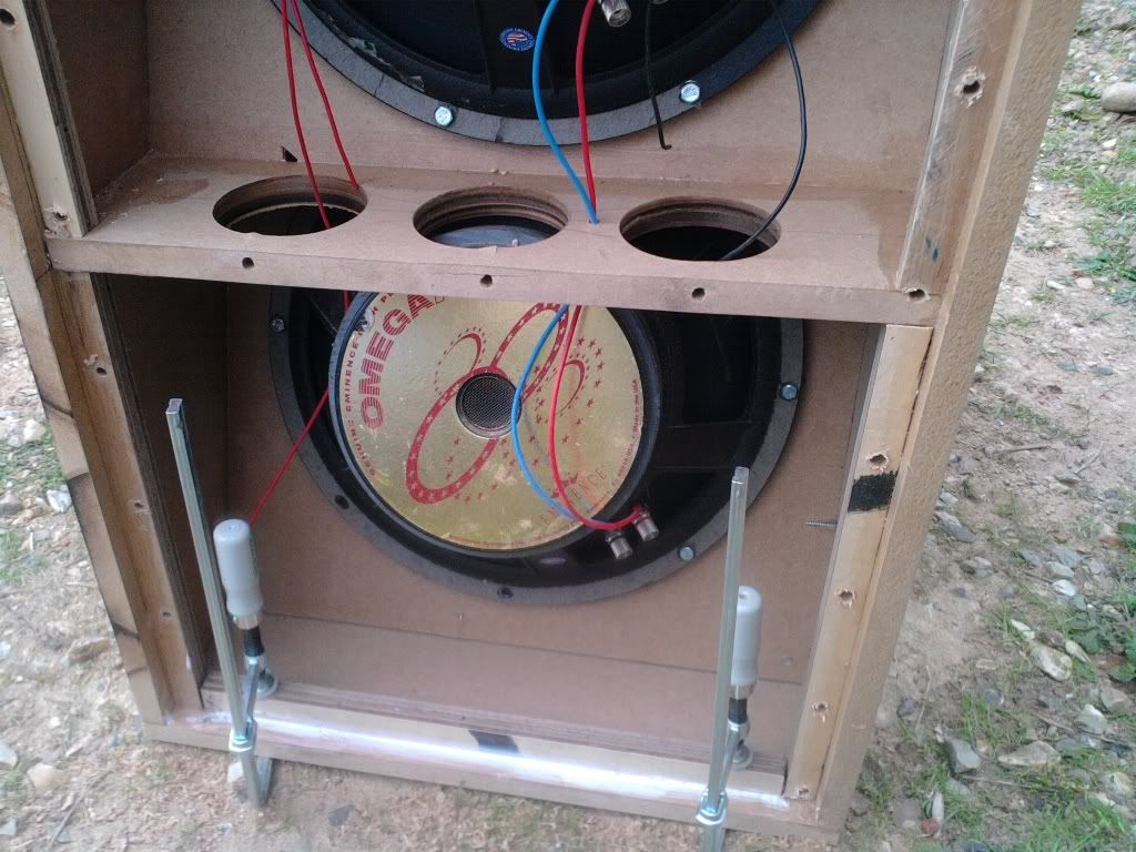

Theres a pic of some omega pros in there.
Did you test them? Really interested to know if they sound good as I have four omega pros 15s and want to build some good horn loaded cabs for strong kick bass. |
