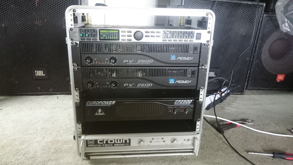

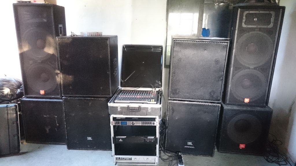

Afternoon... I'm new here and around 2 months ago decided I wanted more bass in my life and also to start putting on nights playing all the genres I love but never get to hear. Stuff like reggae, dancehall, hip hop, rave, jungle... a lot of oldschool. All I seem to here is the latest techy agro music!
So I started with two Alto TS Sub 18 active subs. One of these started rattling after the first party I did with them so I sent both back and got a refund.
I then bought four JBL SoundPower P744 18" subs (4 ohm) and two Peavey PV2600 power amps.
I then bought a Crown MA3600VZ and a behringer ultradrive.
I then got a deal off a mate comprising an amp box containing a behringer EP2500, Crown XLS602 and a DBX Driverack, a soundcraft E12 mixer in a case, two JBL SF25 mid tops, two JBL M-pro 418 passive subs and all the speaker and audio cables I would need for everything.
I also have a spare pair of drivers, for which I'm going to house in some as yet undecided and unmade bins.
Here's a couple of pics.

I'm pleased with how good it sounds... it makes your T-shirt flap and certainly has output below 40hz and is clear and doesn't hurt your ears. The cheapo JBL mid tops actually sound fine if you cross them over around 100hz... below that and it gets muddy, probably due to cheap drivers.
Any suggestions much appreciated :) esp on which subs to build to with it!

You could look at using the 4x reflex bins as upper bass. But those midtops look like double 15" that would also kick decently.
And you want to build more subs? You already have a decent enough sub and kick section! It's just making the most out of what you already have.

Also that's a DCX not a DBX driverack? Smile

But then he will have 2x unnamed cabs with said 18" drivers, 4x 18 JBL soundpower subs and 2x JBL m pro subs. All designed to do the sameish frequencies.
Might be better using the 4x sound power subs on the bottom and putting the 2x spare drivers into a pair of ES18 or something similar for kicks.

Yeah the mid tops are dual 15". You can feel the kick in your chest.
Edit: I believe he just wants to make something out of the spare drivers.
It is... the DBX is out of shot. I actually prefer the DCX!
Also out of shot is a broken crown XLS602 lol...
