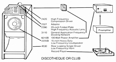

I still have some JBL 2420s that I bought back in 1980.
The upper frequency response rolls off above 10KHz and with an 800Hz high-pass cross-over 10W RMS is about their limit, and if you are mainly playing highly compressed music, perhaps even less. Despite their large physical size, they are old and fragile. Having just checked the price on ebay $749 for a pair, I would sell them. For that amount, you could get a pair of modern coax drivers, and would be less likely to blow them up. Either that, or put them on a shelf, admire them, and buy some cheap modern compression drivers. |

A few questions: I presume your 2310 crinkle-plate lenses include the 2309 horns, to make up a complete 2390 ? They were normally used with 2" drivers such as the 2440. Do you have the 2327 adaptors to fit them to the 1" throat 2420 driver? -- The 2420 was rated at 30W above 800 Hz. They used aluminium diaphragms which are prone to shattering into confetti (as a result of metal fatigue) if driven hard at low and mid frequencies. New diaphragms are expensive. You should check the diaphragms on yours to make sure they are OK, and - but only if you know how to - clean out the gaps. Although some vintage JBL studio monitors used them with passive crossovers, these were not high power systems. I wouldn't want to use one below 1500Hz on a system such as yours, and only then with its own amplifier driven by a 24dB/8ve active crossover and suitable protection - a series capacitor at the very least, and preferably a (Martin style) filter with capacitor, autotransformer, and swamp resistor. They do sound nice, and if you want to add a tweeter you can cross over at 7kHz. The classic JBL systems used either a 2402 ring radiator or a 2405 diffraction slot. As noted by fudge22, if you can't be sure of using them within their limitations, you may be better off selling them. They are highly sought after by hi-fi aficianados, especially in the Far East. I think you would be better off getting some good 2" drivers to fit the lenses, and adding tweeters for 7kHz and above. And build some horn loaded 10" or 12" mids to go between the kicks and 1500 Hz. Edited by madboffin - 09 February 2025 at 1:19pm |

Hey Madboffin, appreciate the input; It is indeed a complete set, so a JBL 2420, 2327 adapter, 2309 horn and finally the 2310 Lens... I have indeed checked the diaphragms and they seem to be fine! Also a sidenote on replacements, originals are indeed expensive but aftermarkets run from 20-40 euros or are these to be avoided at all costs? Thank you very much for a detailed write up on how you would run them! Given their age and expensive it seems a bit of a hassle really for some garden parties 2-3 times a summer... I think I will keep the 2420's for perhaps a bi-amped hifi system with tubes :) I wasn't expecting my system to become a 5 way anytime soon but it seems I don't have much of a choice with a sub & kick section and the 2310 lens' crossover... But my future plans of going BR for subs will allow me to have bass & kicks in one cab (thoughts on this?) so I'd be back to a 4 way then :) What are some good 2" drivers you like and what should I look for?

hi,
for the horn and lens, you could make a custom adaptor to use modern drivers. scoops like yours or the jbl 4530, which was paired with your horn back then, can be used 60-1000 hertz, but it depends on the music you want to play if that sounds right. since you have them already… try it! might be better than the cheapos J. Edited by julius111 - 26 March 2025 at 7:58pm |
