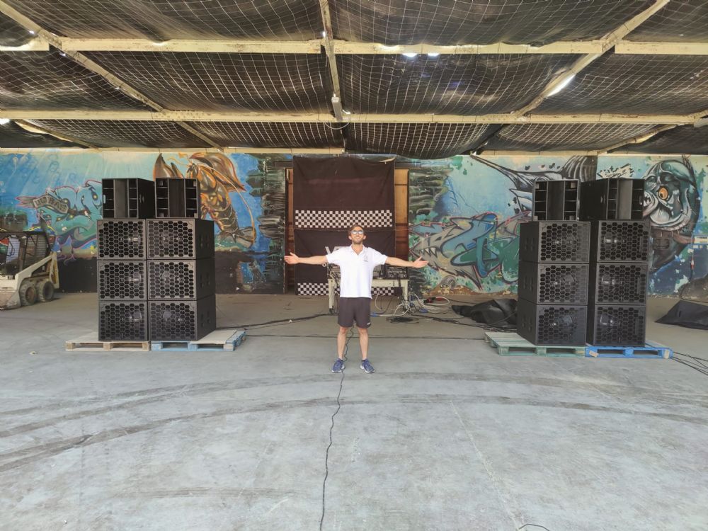

Your budget will buy you something like this in a turn key way with all the electronics included.
