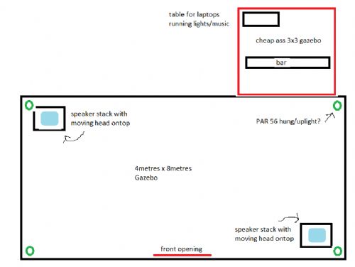

ok lads ive got an idea.... (love the italian job- great movie)
this is the way im seeing it in my head. nice big party tent and a smaller one off one side so theres room to let lose.
not to scale nor are the stacks facing the right way but the way its set up is wat im thinking.
four PARs one in each corner (hanging down facing the dance floor or on the floor lighting the walls and ceiling up?) to scanners/moving heads ontop of the stacks and then as i said earlier maybe a single white rope light running the whole way round the top (inside) on a DMX dimmer pack that i can use as a 360degree strobe! (and room lighting for the end of the night when i gotta clear this sh1t up lol)

To keep it on track I'd not go with the pars in the corners pointing at the dance floor or you'd loose the dark spaces that beam lights work so well in. I know others will disagree with me but a couple of moon flowers in corners pointed at the dance floor with a bit of haze is quick, easy and effective. You can pick up a second hand pair of Abstract Twister 4's for less than £60. Don't saturate the place with light, darkness is your friend. Did many years of large warehouse raves with just 4 Goldenscans, 4 strobes, some solar 250's and a handful of pars for functional lighting (bars, stairwells, dim light on Dj)

nooooooo..... i think you have misunderstood.  i dont intend to use all the lights at the same time. the rope i think im gonna leave out for now too. i want lights i can chase around the room and be dimable. i dont want to just throw light at the dance floor. the scnners would one second then tthe PARs would chase round the room one at a time in a strobe effect. theres gonna be no effect thas just gonna be left on alll the time.
the reason for the PARs in each corner is their multi use i dont want to just use them as a wash i want their multi colour fast reaction seperate DMX addresses to be their versatile-ness. i use to qork as a roadie for a moblie dj years ago and he had two 4way dimmer packs and a few "effects on sticks" and i use to manually play with them all night (old skool inteli-lighting lol) and the effest of having the different colours on different channels and using flash buttons on the 4ways proved really effective.
i refused to let him just press the sound to light button and it kept me amussed all night.
does that make sense? lol

Agree with James on the gobo flower suggestions. Twister 4 have great sound to light, and I pretty much started out again with Destroyers, and why I still have 6 of them (and Solars, just like everyone else says, think I bought a load of bits off funky parrot years ago actually)

Yep, it made sense, it's just I find most led wash fixtures to be too wide for that sort of thing. The link you posted had small cells, so was very effective. Plus with only 4 fixtures and a surround layout it's gonna be very much a set look, sure you can do odds and evens, flash rounds, lefts and rights in lots of colour options, but as led fixtures dont mix colours that well people are still looking at red, green and blue sources. Think in layers, what you have there are only two layers. Add a couple of cheap beam effects in the corners and you have another layer. If run off a desk you can control a pair of twister 4's, for instance if you had the heads doing sweeps in a blue gobo, a chase on the led pars in yellow, then a third layer of the twisters flashing in. I got the fact you wanted to op rather than just leave things on sound to light. Add a couple of strobes for a fourth layer, then maybe consider another specials layer. I'm a big fan of specials, something you might only use only once or a few times. I worked for a Dj who had a big track with a "Let there be light" sample, and I would rig a dozen wide theatre profile lamps around the venue at floor level, pointing in and across the floor and shuttered hard. When the tune dropped and the sample came in I would flood the floor with open white light, and with the right amount of low smoke the effect was one of being stood on a cloud. Only used it once a night, made that moment very special. Gave some people vertigo, often made people fall over. Took half an hour to throw out but oh so effective

i do love all help im getting, i really do, but i want to keep it all DMX (no sound to light) i believe using a select choise of lighting i can create some outstanding effects with some very simple patterns and switching between different effects. KISS.. im keeping it simple yet highly effective by having some choise lights and hours and hours creating complex sequences for 45 mins of light display i can then loop for 5-6 hours worth of lighting.
