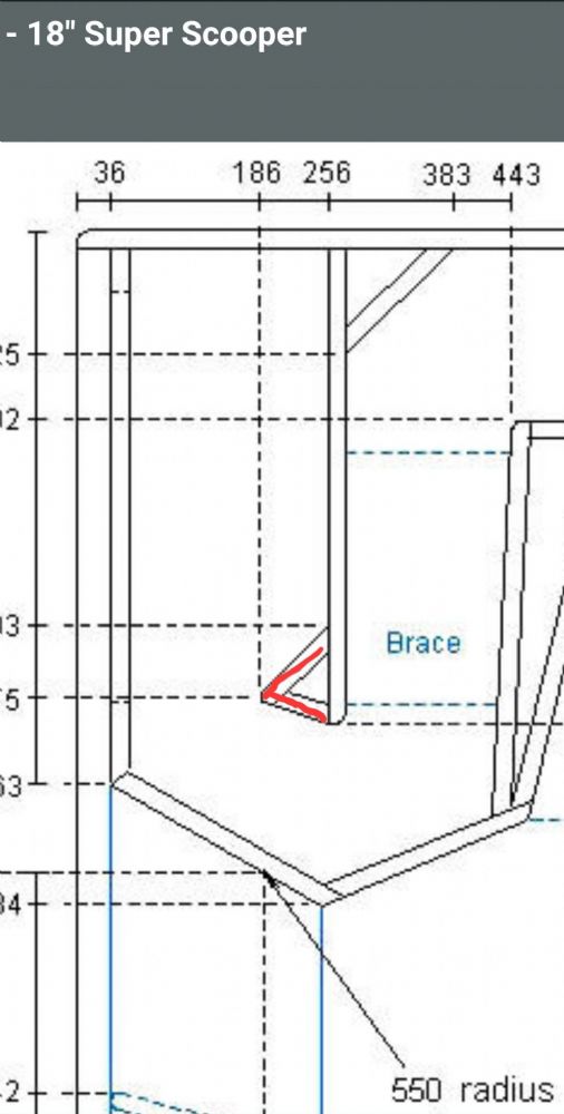

if you take the dog leg out , the super as an animal with 51 and 52 , tried some here , will have the s118 easy if its a good build ,ASS ok with 52 but can not keep at full tilt for hours and hours the sides of the cab get very hot as the chamber and more important  the throat is way to small ,( the 52 has 23mm in there )  no good for hire outs ok if you playing 3 for 3 and chopping out the bass lol , i heard some supers with dog leg in the weekend with 1850 , forgot how bad they are with leg in :(
So basically just remove/leave out these two small boards that form the triangle/dogleg?

Yes
