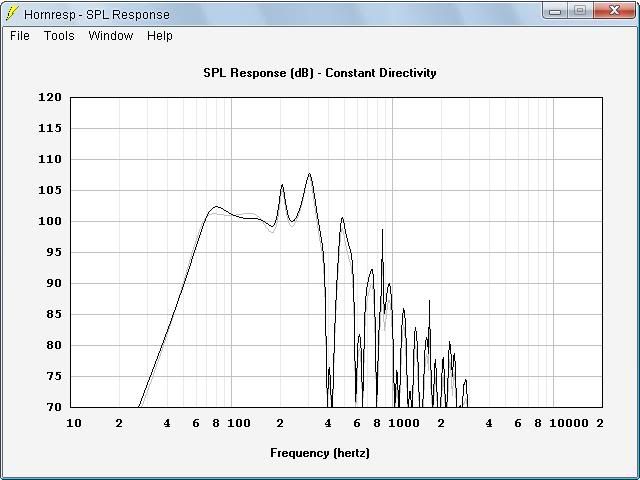

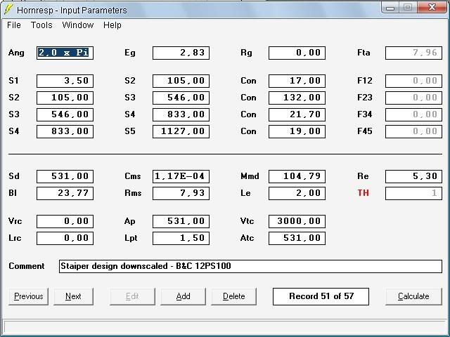

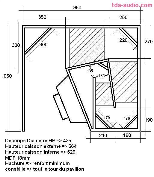

Post Options Post Options   Thanks (0) Thanks(0)   Quote Ibex Quote  Post ReplyReply Direct Link To This Post Posted: 14 June 2009 at 1:34pm
Another tapped horn alternative is the Staiper Design (TH Mini style).
Again downscaled, not loaded with the 18Sound but with the original TH Mini driver B&C 12PS100.
The reason why i simulated it with the B&C driver is that the response with that driver is smoother than with the 18Sound.
Here the original Staiper Design which is a little bit bigger than the original TH Mini, on which the design is based on:
Dimensions of the downscaled version are:
610x475x380mm (24x18,7x15inch)
Staiper Design (TH Mini style) downscaled - B&amp;C 12PS100 - Hornresponse Input Data
Staiper Design (TH Mini style) downscaled - B&amp;C 12PS100 - SPL
black = 1x
grey = 3x

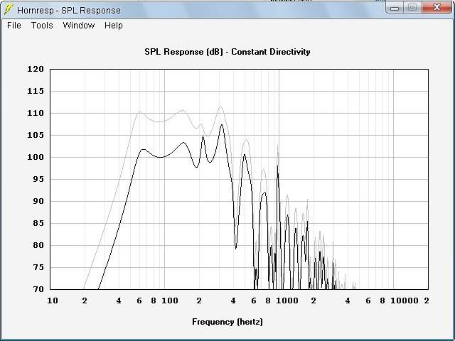

Post Options Post Options   Thanks (0) Thanks(0)   Quote Ibex Quote  Post ReplyReply Direct Link To This Post Posted: 14 June 2009 at 1:41pm
Here is to compare the simulation with the 18Sound:
Staiper Design (TH Mini style) - Comparison 12PS100 vs. 12LW1400 - SPL
black = 18Sound 12LW1400
grey = B&C 12PS100
